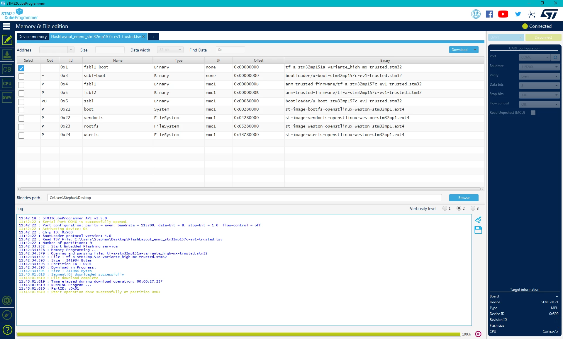

Alright, i was able to compile the TF-A with my devicetree. But the STM32Cube Programmer crashes at 100%.
If i turn on verbosity level 3 it already crashes at around 60%.
I managed to make a screenshot before it crashed.
Olivier GALLIEN
Sep 29, 2020 8:16 AM UTC
Hi @SJans.1​
I notice you use your custom "variant-high-mx" as fsbl-boot but ev1 flavor in fsbl1 ?
Please confirm you are on custom board ?
I suspect your tf-a "variant" to be not functional for some reason.
You may know that the fsbl-boot should have a specific "serial" profile to allow programmation with STM32CubeProgrammer.
Can you please share UART console traces during flash operation ?
Thx
Olivier
SJans.1
SJans.1Author
Sep 29, 2020 9:20 AM UTC
yes i am using a custom board. And as a first step i only try to get the fsbl-boot running. So i ignore all the other partitions.
The ioc-File from which i compiled the Tf-A is attached above at my first question.
With serial profile you mean baudrate settings etc.? CubeMx does not allow me to change any settings for UART4. It tells me "this ip has no parameters to be configured"
I attached a UART trace.
fyi: i tried to flash this on my custom board but also on the Eval-Board. Same results.
