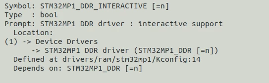

The first things to do is search “DDR_INTERACTIVE�?. To realize a search in the menuconfig, you have to hit “/�? key and type the text that you search.
A window like this appears:

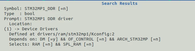

As you can see, “STM32MP1_DDR�? is set to [=n] because you have to enable “STM32MP1_DDR�? before being able to enable DDR_INTERACTIVE.
So search “STM32MP1_DDR�? .
0693W00000HoWwyQAF.pngYou see that you have to enable "OF_CONTROL" and "ARCH_STM32MP" before enabling your configuration

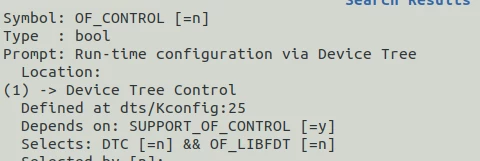

So one more search, search for “OF_CONTROL�?
You can hit the key “1�? to directly go where the config is located or you can search it inside "-> Device Tree Control"
Enable the configuration.

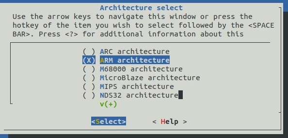

Then to enable "ARCH_STM32MP", you have to change the architecture type from Sandbox to ARM.
This can be done at the root of the menu:
Select ARM architecture in the list.

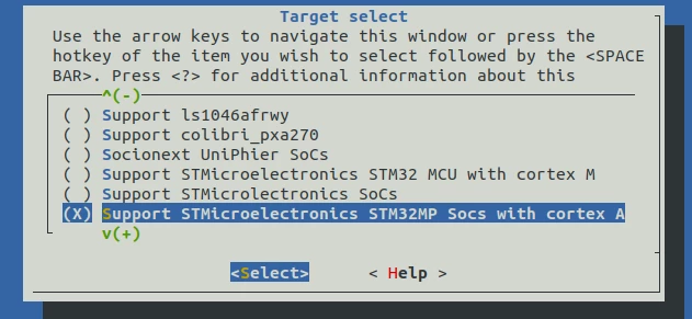

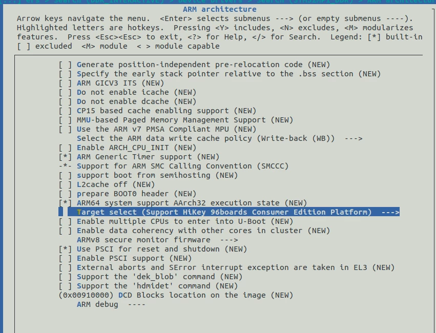

Now, a new menu appears “ARM Architecture�?. Go inside and looks at “Target select�?.
0693W00000HoX0HQAV.png Modify it to select “Support STMicroelectonics STM32MP Socs with cortex A�?
Finally, you can search again “DDR_INTERACTIVE�? and you will see that you enabled the needed “STM32MP1_DDR�? !
0693W00000HoX1KQAV.pngHit the key “1�? to go directly in the correct submenu or go in:
Location:                                                                               │
 │    -> Device Drivers                                                                     │
    │      -> STM32MP1 DDR driver (STM32MP1_DDR [=y])
And enable it.
The CONFIG_STM32MP1_DDR_INTERACTIVE configuration is now activated.

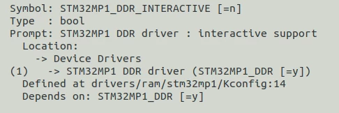

Modify configuration and enable DDR_INTERACTIVE
Firstly, to modify the configuration you have to use in the U-Boot folder, the command “make menuconfig�? as explained on the wiki: https://wiki.st.com/stm32mpu/wiki/Menuconfig_or_how_to_configure_kernel
CONFIG_STM32MP1_DDR_INTERACTIVE is not the easiest configuration to enable because it implies to have already enabled other configurations.

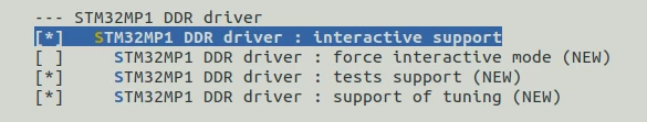

Location:                                                                               │
And enable it.

I just saw that I provided you the complete procedure to activate the DDR_INTERACTIVE mode for the U-Boot, but I'm sorry because there was an easiest way as explained on the U-Boot SPL page:
https://wiki.st.com/stm32mpu/wiki/U-Boot_SPL:_DDR_interactive_mode#DDR_interactive_mode
It is possible to compile to force DDR_INTERACTIVE mode by adding DDR_INTERACTIVE=1 in the make option.
So you just have to add DDR_INTERACTIVE=1 in your make command line.
The option will be handled by the makefile : drivers/ram/stm32mp1/Makefile
That will force the activation of : CONFIG_STM32MP1_DDR_INTERACTIVE_FORCE
FIP
Regarding FIP, it is normal that you do not have FIP partition because you are using a partition scheme to use an U-Boot SPL.
I forgot that point during the previous answers.
So I explained you how to generate an image with a FIP package which is the normal way to use the environment v3.1.0, but it was not related to your main question.
DDR INTERACTIVE for U-Boot SPL
To answer your main question, the only thing that you need to do to build your U-Boot SPL with DDR_INTERACTIVE is explained in the chapter 5 of this page (you must expand the chapter that is not displayed by default): https://wiki.st.com/stm32mpu/wiki/STM32MP15_U-Boot#SPL_compilation
You have to use the basic config and not the trusted one:
PC $> make stm32mp15_basic_defconfig
and add the DDR_INTERACTIVE option in the make command:
PC $> make DEVICE_TREE=stm32mp157c-dk2 DDR_INTERACTIVE=1 all
And that's all!

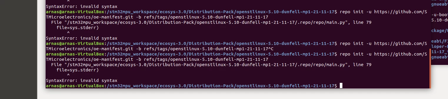

Arnas Celkys
Dec 16, 2021 11:59 UTC
I have tried "How to populate the SD card with dd command" (url: https://wiki.st.com/stm32mpu/wiki/How_to_populate_the_SD_card_with_dd_command). But this requires the Distribution Package. Then I have followed the "https://wiki.st.com/stm32mpu/wiki/STM32MP1_Distribution_Package" to get the distribution package and got the following error to repo init ****. :
repo init -u https://github.com/STMicroelectronics/oe-manifest.git -b refs/tags/openstlinux-5.10-dunfell-mp1-21-11-17
 File "/stm32mpu_workspace/ecosys-3.0/Distribution-Pack/openstlinux-5.10-dunfell-mp1-21-11-17/.repo/repo/main.py", line 79
  file=sys.stderr)
SyntaxError: invalid syntax
0693W00000Hopv1QAB.pngso feels like I am in some deep rabbit hole :grinning_face_with_sweat:

  2. Updating Ubuntu to - 20.xx version solved the issue with SyntaxError: invalid syntax in SDcard population issues
