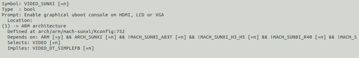

The configuration that enables the hdmi video driver is VIDEO_SUNXI, which is disabled by default:

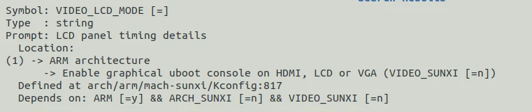

And the configuration which allows to choose to use the HDMI is CONFIG_LCD_MODE :
0693W00000JO4lkQAD.png But it is also disabled by default

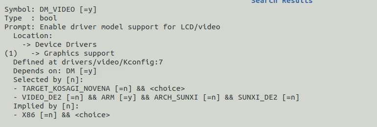

Maybe you are talking about the support of the DSI peripheral, in this case you can disable it by disabling DM_VIDEO :
0693W00000JO4nkQAD.pngIf this configuration is disable, the compelte driver model to support video will be disabled, even the splash screen of u-boot will be turned off.
