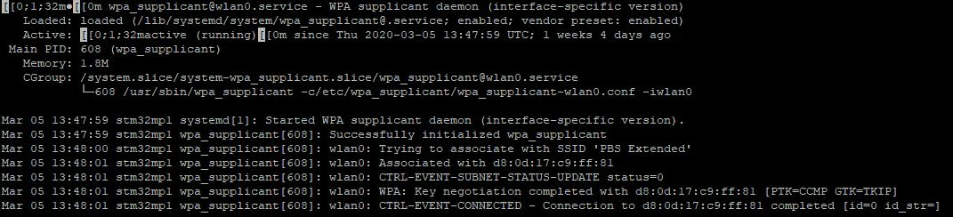

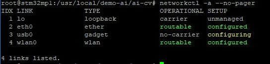

Could you please share results of :
$> networkctl -a --no-pager
and
  $> systemctl status wpa_supplicant@wlan0.service

Following is the result of $> networkctl -a --no-pager:
The output of  $> systemctl status wpa_supplicant@wlan0.service is as follow:
