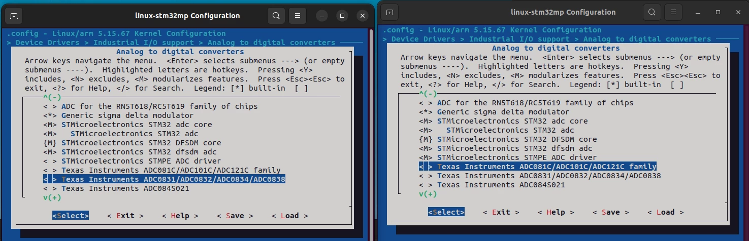

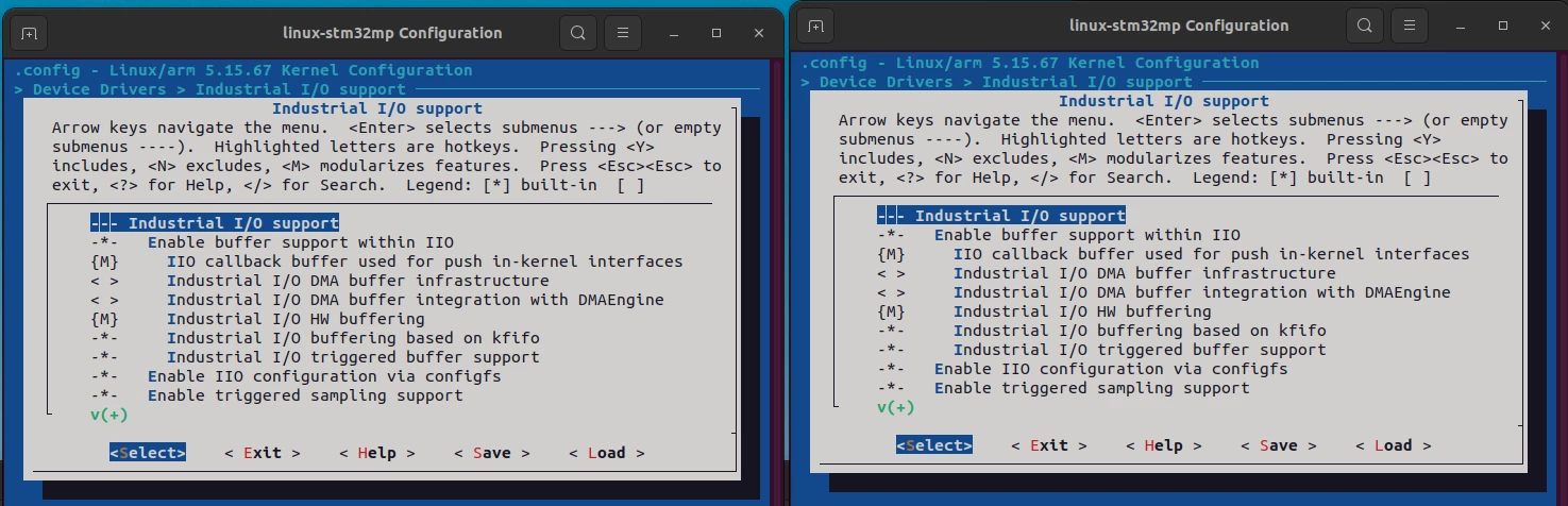

MWoło.2
MWoło.2Author
Senior III
March 17, 2023
The configuration of both board

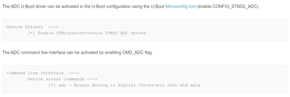

0693W00000aJDsSQAW.png0693W00000aJDrKQAW.pngI can't find only the U-Boot drivers
0693W00000aJDusQAG.pngDo U-Boot configuration (dts+driver) significant?
