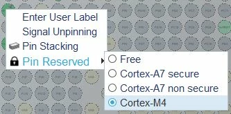

Hi, I am currently looking at how to enable a GPIO pin on the M4 with the MP157A-DK1 kit.
In the datasheet it is unclear to me how I can assign the gpio pin specifically to one of the two processors (A7 or M4) or is this not necessary?
Thanks,
Rens
6 replies
PatrickF
February 4, 2020
Once GPIO is set in CubeMx, use Right-Click to assign to Cortex-M4.
This will ensure the generated code is present in main.c
In order to give better visibility on the answered topics, please click on 'Best Answer' on the reply which solved your issue or answered your question.Tip of the day: Try Sidekick STM32 AI agent
