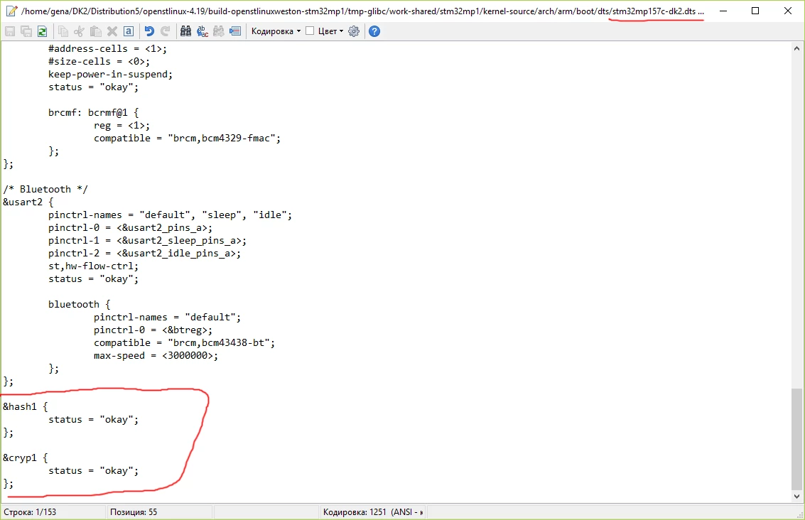

I am trying to generate my own image Distribution package for my DK2 board.
How to assign hardware cryp1/hash1 to A7 kernel?
Do I need to modify some .dts files? Or do I have to enable some options in menu config?
Give me please step-by-step recomendations if it is possible.
Thank you.

I have added these lines to the end of the file "stm32mp157c-dk2.dts":
Than I clean and build the image again
bitbake st-image-weston -c cleanall
And download basic image to the DK2 board using STM32CubeProg.

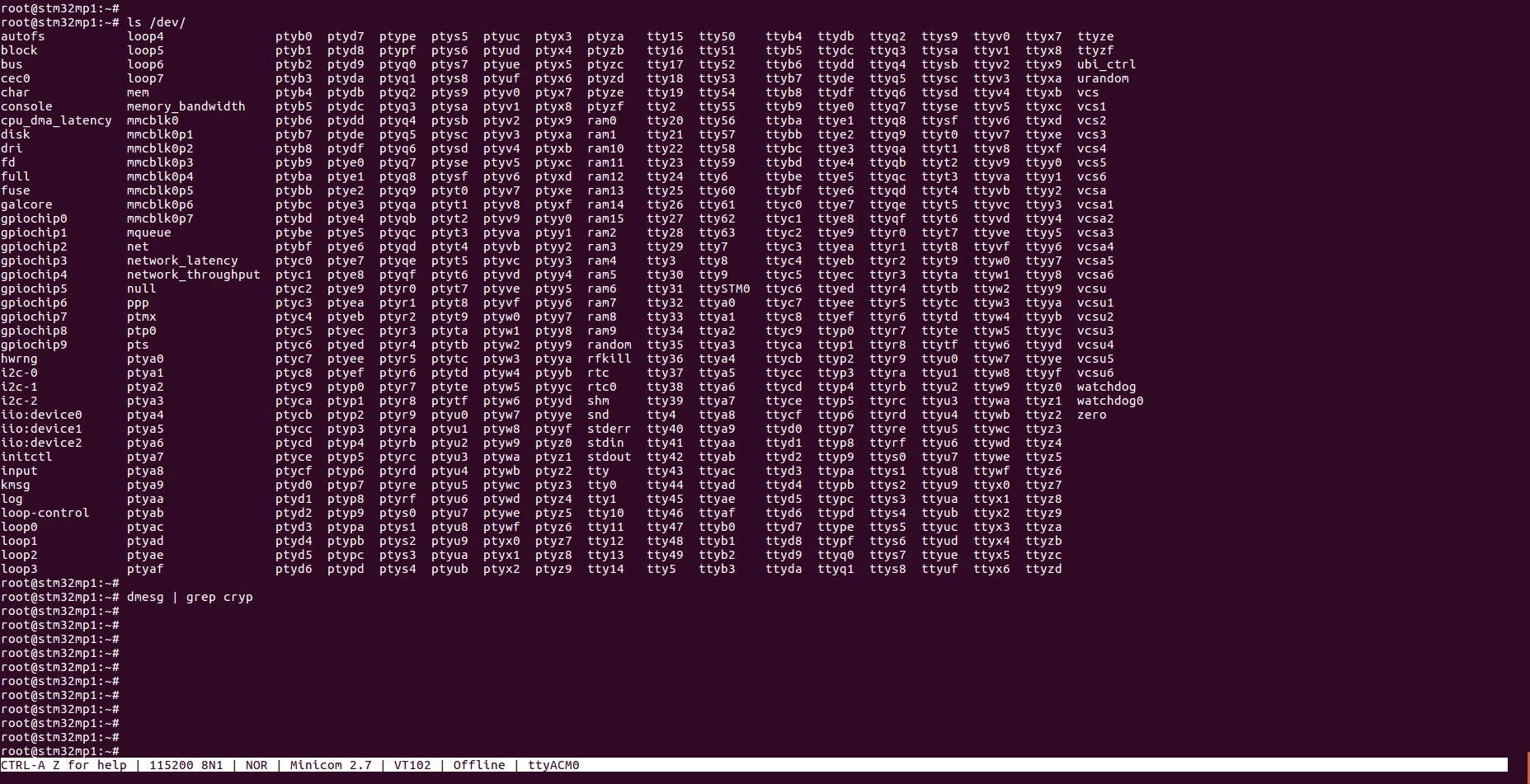

Unfortunately there are no any cryp devices in /dev/
What I am missing here?
