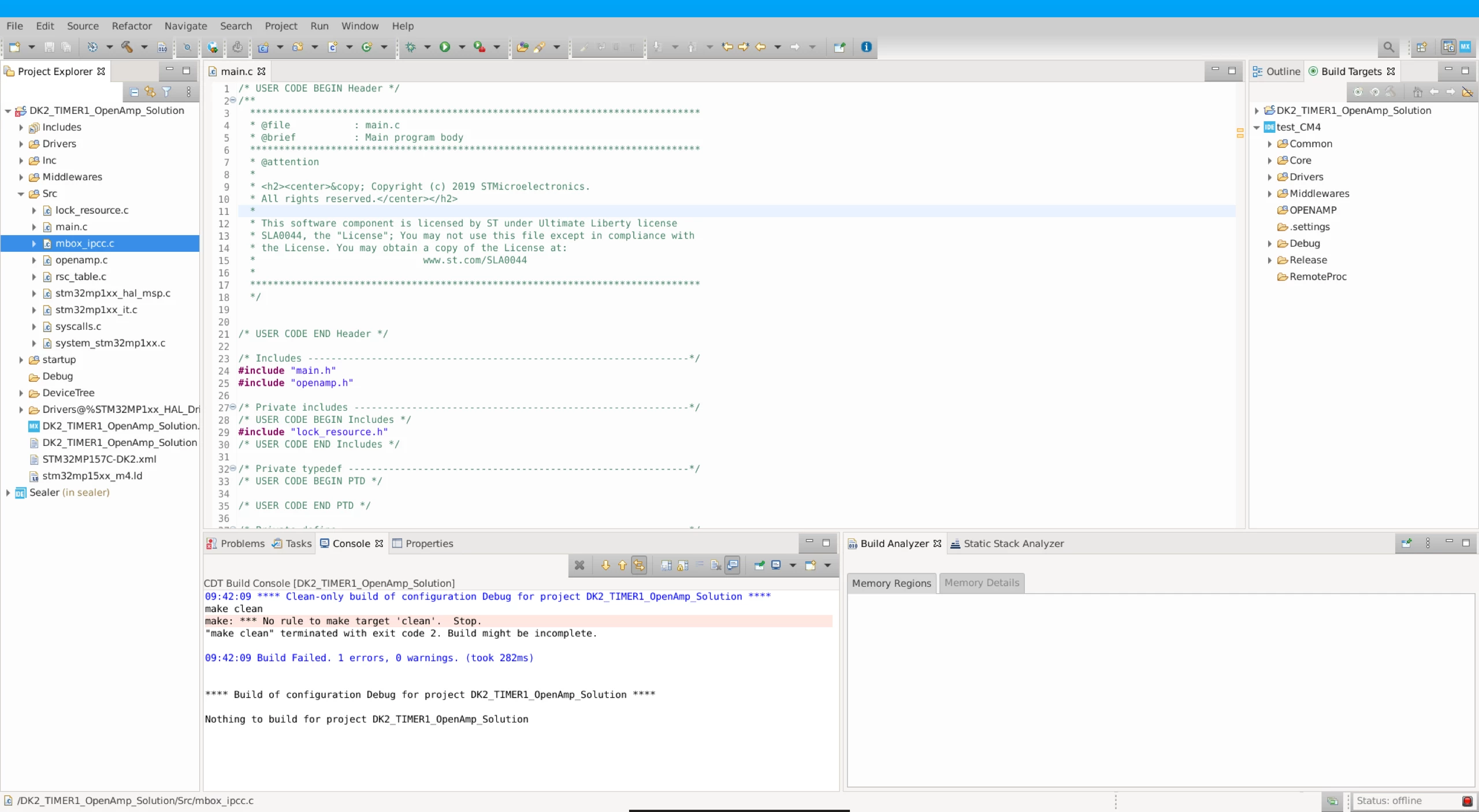

Hello @msche.1​ ,
I assume that you followed the step from the video.
Please can you send me a screenshot of your project explorer on the left side of CubeIde and the complete log from the CubeIde Console when you hit the hammer (build button).
Regards,
Kevin
msche.1
msche.1Author
Jan 31, 2022 17:44 UTC
Yes, I followed the steps. Basically just unzipped, imported and built.

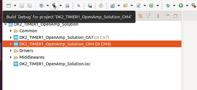

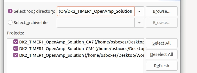

Hello @msche.1​ ,
Sorry for the late reply.
I was finally able to work on your problem by installing the VM and trying to build.
I encountered the same issue than you by using the content described in the video.
The video was made with ecosystem 1.0.0 which is very old and with the tool STM32Workbench, which is now replaced by STM32CubeIDE, so the project syntax was different. That is why you were enable to build the project.
Procedure:
  • Then it is not obvious, but you have to go in the folder "OpenSTLinux_3_0_Update":
https://drive.google.com/drive/u/0/folders/1KQGGmHOE9Zq44O6KfNqAYMaGgkYwt42h
and download the folder "WorkshopUpdates_3_0_0-1.zip", which contains all the projects updated for the latest OSTL version.
  • You will find the folder "WorkshopSlides" with all the slides updated, so I advise you to use them in the same time than the video. You can also read the "README.TXT" inside the folder.
  • Go inside the folder "InputLabMaterial/Lab-M4" and unzip STM32Cube_FW_MP1_handsOn.zip
  • Finally, if you import the project in CubeIde 1.8.0, you will see 3 projects:
0693W00000JPvJ1QAL.pngClick on finish and select "DK2_TIMER1_OpenAmp_Solution_CM4" in the project explorer and click on the build icon (hammer):
You must be able to build the project.
