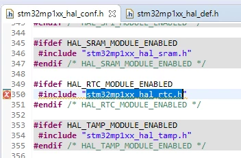

"No driver is provided for this,..."
Is it temporary or there are plans to make the stm32mp1xx_hal_rtc.h available? If so, what is the ETA?
Is can see that the hal conf can already handle it...
Thanks,
PatrickF
Aug 1, 2019 07:16 UTC
I'm quite sure there will be no driver for RTC in HAL in future as RTC always need to be controlled by Linux side, despite you can see some entry in hal_conf.f which need to be ignored.
If you want to retrieve similar functions than other MCUs, you could probably port some HAL function code from other STM32 products (e.g. STM32CubeH7), but need to be strip down the code to bare minimum to avoid initialization and access to any restricted RTC registers. Not sure it is worth the effort.
