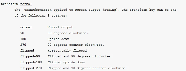

How can I rotate the screen?
Hello.
I'm making custom board ​with stm32mp157AAA.
lcd works nomally, but i want rotate this to 90.
Please help me.
thanks

Hello @DLee.15​
I don't know if you are still trying to rotate your screen, but the section that must especially interest you in the link provided by @Community member​ is:
https://wiki.st.com/stm32mpu/wiki/Wayland_Weston_overview#Configuration
In order to give better visibility on the answered topics, please click on 'Select as Best' on the reply which solved your issue or answered your question. See also 'Best Answers'
*edited to add a picture

Hi @DLee.15​ ,
If you are using weston wayland please have a look to :
Olivier
