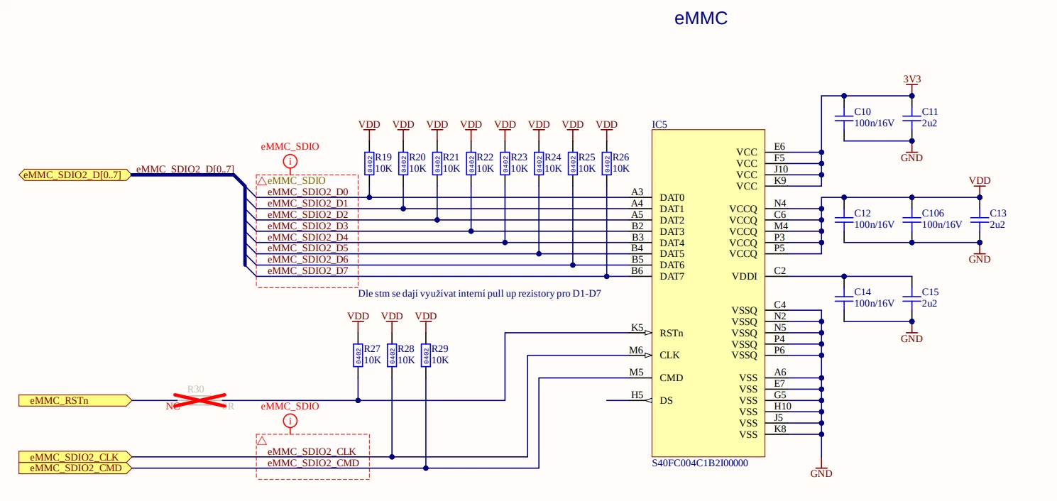

Bernard PUEL
Sep 23, 2021 13:58 UTC
if EMMC IOs are at 1,8v, you will need to replace "mmc-ddr-3_3v" with "mmc-ddr-1_8v"
And
if the EMMC IOS are at 3,3v, you will need to replace "&vdd" with "&v3v3"

Tomáš Juřena
Senior
Sep 29, 2021 12:23 UTC
No, the main supply is 3v3 but the communication logic (signal voltage) uses the 1v8. I attach the schematic of the eMMC.
