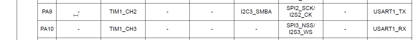

And in relation to that, I noticed that in your Linux DTS, that you were using the pins PZ6 and PZ7:
	usart1_pins_z_mx: usart1_mx-0 {
		pins1 {
			pinmux = <STM32_PINMUX('Z', 6, AF7)>; /* USART1_RX */
			bias-pull-up;
		pins2 {
			pinmux = <STM32_PINMUX('Z', 7, AF7)>; /* USART1_TX */
			bias-pull-up;
			drive-push-pull;
			slew-rate = <2>;
	usart1_sleep_pins_z_mx: usart1_sleep_mx-0 {
		pins {
			pinmux = <STM32_PINMUX('Z', 6, ANALOG)>, /* USART1_RX */
					 <STM32_PINMUX('Z', 7, ANALOG)>; /* USART1_TX */
As you can see PZ6 and PZ7 are parts of pinctrl_z, which are the secure pins of the device.
And inside your TF-A DTS, you are using the USART1 in non secure mode:
DECPROT(STM32MP1_ETZPC_USART1_ID, DECPROT_NS_RW, DECPROT_UNLOCK)
I didn't reproduce the problem yet, but maybe this misalignment creates a bad behavior.
If you are still working on that, please can you make a test with two other pins?
For instance, PA9 and PA10 (DS12505 v7.0 page 93) :
0693W00000QKOPsQAP.pngor another one that is not a PZ pin and that supports USART1 as Alternate Function.
