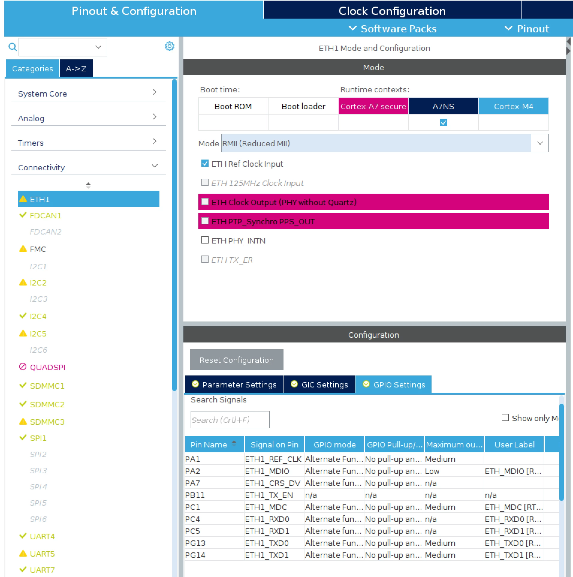

How can i change the interface RGMII to RMII using CubeMX?
Hello Guys
Like the subject, I want change the interface RGMII to RMII using CubeMX.
(RealTek-RTL8211EG-VB-CG => Microchip - LAN8720AI-CP)
Based on STM32MP157C-EV1 Code in CubeMX, I changed the Ethernet option from RGMII to RMII as shown in the picture below.
0693W00000D03NZQAZ.png​
And after Code Generating, I applied it to my addon(mx) directory and built it.
(Changed to the code generated by CubeMX.)

However, it seems that the ethernet chip is not recognized as shown in the log below.
~# dmesg | grep eth
[ 0.000000] psci: probing for conduit method from DT.
[ 1.236408] usbcore: registered new interface driver cdc_ether
[ 2.756520] stm32-dwmac 5800a000.ethernet: PTP uses main clock
[ 2.760976] stm32-dwmac 5800a000.ethernet: no reset control found
[ 2.767028] stm32-dwmac 5800a000.ethernet: No phy clock provided...
[ 2.773905] stm32-dwmac 5800a000.ethernet: User ID: 0x40, Synopsys ID: 0x42
[ 2.780299] stm32-dwmac 5800a000.ethernet: DWMAC4/5
[ 2.785190] stm32-dwmac 5800a000.ethernet: DMA HW capability register supported
[ 2.792527] stm32-dwmac 5800a000.ethernet: RX Checksum Offload Engine supported
[ 2.799835] stm32-dwmac 5800a000.ethernet: TX Checksum insertion supported
[ 2.806696] stm32-dwmac 5800a000.ethernet: Wake-Up On Lan supported
[ 2.812984] stm32-dwmac 5800a000.ethernet: TSO supported
[ 2.818278] stm32-dwmac 5800a000.ethernet: Enable RX Mitigation via HW Watchdog Timer
[ 2.826149] stm32-dwmac 5800a000.ethernet: device MAC address be:10:95:ec:a0:c7
[ 2.833449] stm32-dwmac 5800a000.ethernet: TSO feature enabled
[ 10.455282] stm32-dwmac 5800a000.ethernet eth0: no phy at addr -1
[ 10.475335] stm32-dwmac 5800a000.ethernet eth0: stmmac_open: Cannot attach to PHY (error: -19)
I have no experience changing ethernet ICs so I need your help.
​If necessary, I can attach the ethernet circuit diagram of my board.
Thanks​

Thank you for your answer.
​In my case I think it's 3.3.1 from your link.
So I applied the line below to the dts file in my addons/mx/PROJECT/u-boot and kernel directory.
 ethernet0: ethernet@5800a000 {
 compatible = "st,stm32mp1-dwmac", "snps,dwmac-4.20a";
 reg = <0x5800a000 0x2000>;
 reg-names = "stmmaceth";
 interrupts-extended = <&intc GIC_SPI 61 IRQ_TYPE_LEVEL_HIGH>,
 <&intc GIC_SPI 62 IRQ_TYPE_LEVEL_HIGH>,
 <&exti 70 1>;
 interrupt-names = "macirq",
 "eth_wake_irq",
 "stm32_pwr_wakeup";
 clock-names = "stmmaceth",
 "mac-clk-tx",
 "mac-clk-rx",
 "ethstp";
 clock = <&rcc ETHMAC>,
 <&rcc ETHTX>,
 <&rcc ETHRX>,
 <&rcc ETHSTP>;
 st,syscon = <&syscfg 0x4>;
 snps,mixed-burst;
 snps,pbl = <2>;
 snps,en-tx-lpi-clockgating;
 snps,axi-config = <&stmmac_axi_config_0>;
 snps,tso;
 power-domains = <&pd_core>;
 status = "disabled";
After that, an error occurs when bitbake. Do I need to apply it to a file other than the one in that location?
