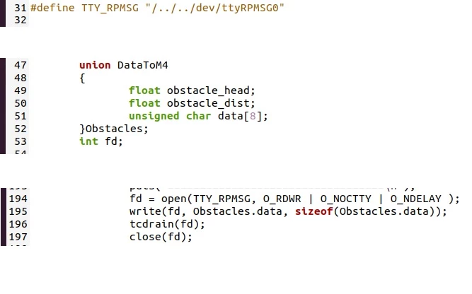

Help on Interprocessor Communication STM32MP157F-DK2
Of the many things I have been struggling withmSTM32MP157F-DK2 throughout this summer, one of them is the interprocessor communication between A7 and M4. I want A7 to process data and send the refined result to M4 for further low level actions. As many users may agree, information in this wiki is scattered with many branches, and while following one topic you encounter references to many links that end up blowing you out if the device is new to you. I am one blown out that way.

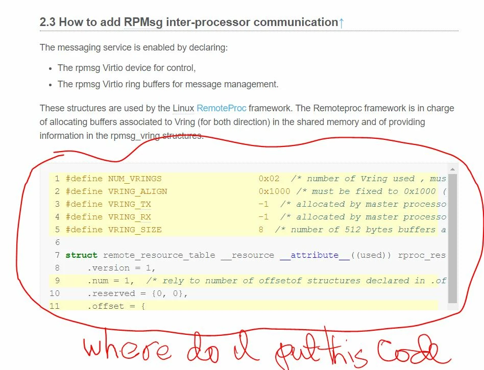

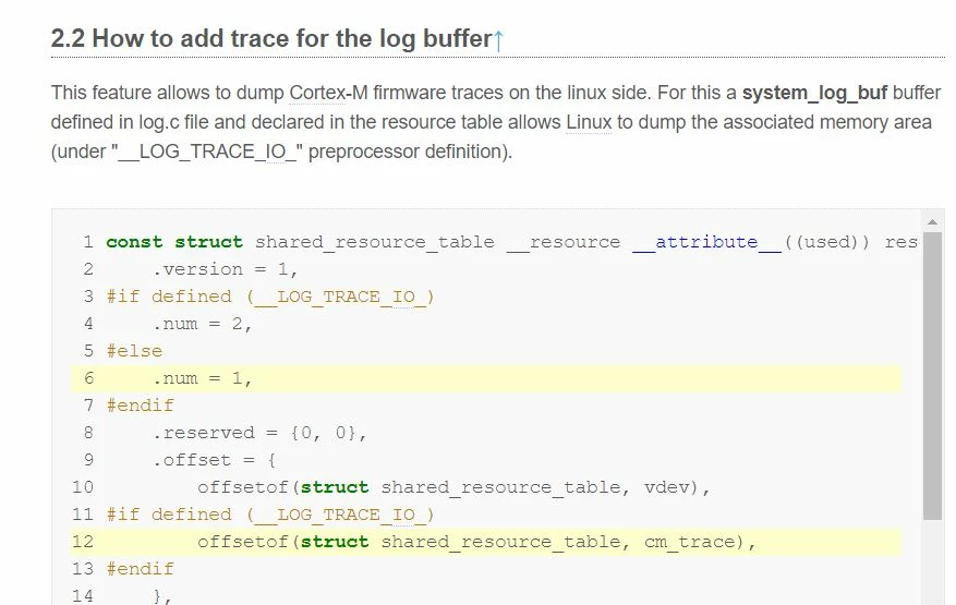

I was reading this post https://wiki.st.com/stm32mpu/wiki/Coprocessor_resource_table and found that I have to have this code somewher in my M4 firware

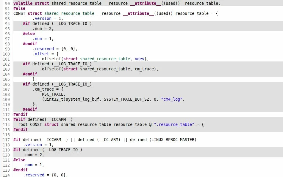

0693W00000DplIQQAZ.jpgwhich I managed (by trial and error) to add in my rsc_table.c as (note sure if that was correct)
Then found rhat I also have to add this code somewhere, but not sure where: whether it is in A7 Linux userland or in M4 firware. Played around many times for over 14 hours and got frustrated.
can anyone help me?

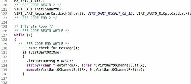

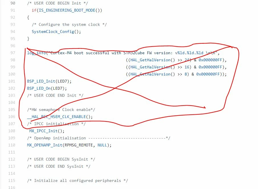

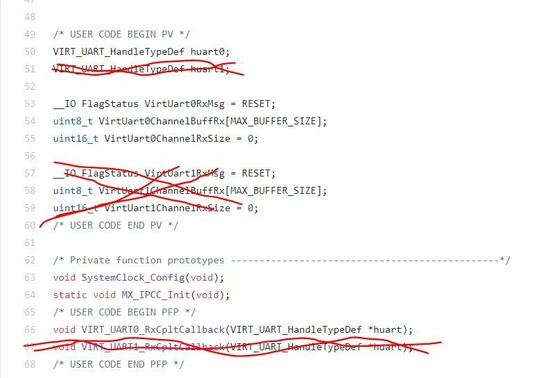

I have compared my code to that of https://github.com/STMicroelectronics/STM32CubeMP1/tree/master/Projects/STM32MP157C-DK2/Applications/OpenAMP/OpenAMP_TTY_echo and found that my project does not have the lock_resource.c which I assume to be created by STM32CubeMX but was not created in my project. All of the following openAMP files are identical
0693W00000Dq3ibQAB.jpgThere are some differences between my main.c file and the one used in the example above. In my plan, I assumed that there will be only one virtual UART channel for sending data from A7 to M4, I did not think that I need a wake up channel, so my virtual UART declarations does not include virtual huart 10693W00000Dq3kmQAB.jpg

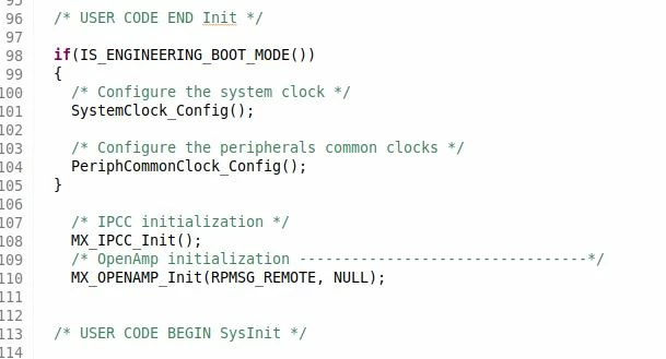

Then in the initialization, my code misses the whole of the following section; I don't know what it means
Instead, my code on that part reads as follows
At the end I enable M4 to start receiving data from A7 as follows
I your view, where do you think I mess up in my code? The A7 Userland application works by just writing the exchange data into dev/ttyRPMSG0 in a continuous loop as follows:

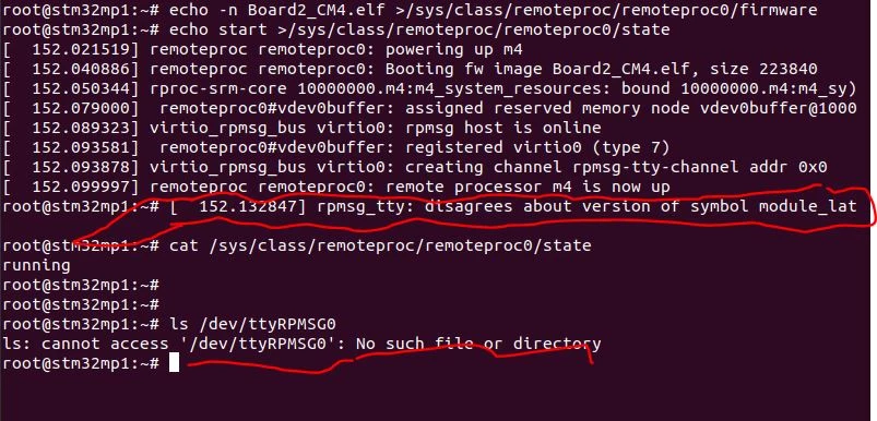

Hello @ArnaudP​  So far I was able to start the M4 firmware but I get a tty error bas shown below; any idea why? The code is exactly more or less like the tty_echo example

Your rpmsg_tty.ko module seems outdated, you probably recompile your kernel with some additional patches without updating the associated kernel modules.
See https://wiki.st.com/stm32mpu/wiki/How_to_cross-compile_with_the_Developer_Package#Modifying_an_external_in-tree_Linux_kernel_module
Here is a tips to avoid to update modules each time you recompile the Linux kernel:
In your Linux kernel source directory
echo "" > .scmversion
Then recompile your kernel

The error does not want to go away even after recompiling and redeploying it. Here are the steps I want through. First I downloaded the latest version of en.SOURCES-kernel-stm32mp1-openstlinux-5-10-dunfell-mp1-21-03-31.tar.xz from https://wiki.stmicroelectronics.cn/stm32mpu/index.php?title=Modify,_rebuild_and_reload_the_Linux%C2%AE_kernel&diff=prev&oldid=77947 and stored it in a directory $HOME/ STM32MP15-Ecosystem-v3.0.0/Developer-Package
Then I followed the following sequence of Command line statements to compile and deploy the kernel; Can you take time go through them one by one so you can help[ me trouble shoot where I err.

Anyway To confirm (or invalidate) the hypothesis of a module compatibility issue, could change the rpmsg_tty driver mode from module to built-in, an retest?

The fact that you have an error message on the rpmsg_tty module indicates that the RPMsg communication has been well initiated. Indeed the Linux kernel received a first RPMsg from the Cortex-M4 firmware. At least from remoteproc node your Linux DT is correct.
