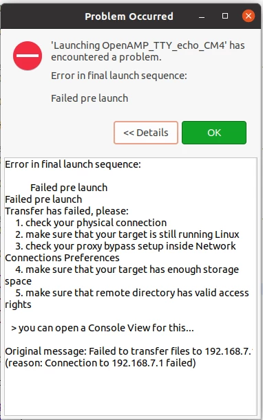

Hello, I followed the video provided by ST ( How to debug M4 in production mode with STM32CubeIDE ) and trying to debug my stm32mp cortex M4 in production mode but I get errors, here is a picture of the error. I hope if someone could help me.

Hi @BJlou.1​ ,
Can you try following the Wiki Getting Starting :
Modify, rebuild and reload a firmware - stm32mpu
You have issue while transferring the file to target through Ethernet over USB connexion.
Check the USB OTG connexion.
Olivier

actually i tryed an other cable but I have the same problem, I've even tryed to debug another board but I got the samething

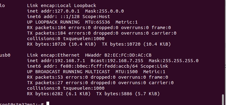

First ensure you can ping your board @192.168.7.1 from HOST when linux has booted
Share board and OpenSTLinux version + ifconfig output
Olivier

the ping command was succefull and i received a rsponse from the board. ( 64 octets de 192.168.7.1 : icmp_seq=27 ttl=64 temps=0.394 ms )
I'm using stm32mp157D-DK1 and stm32mp157F-DK2 boards ( same problem on both boards)
