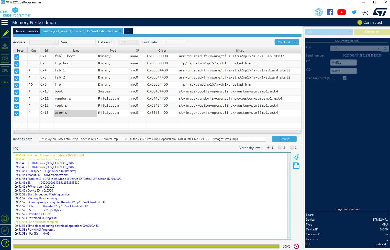

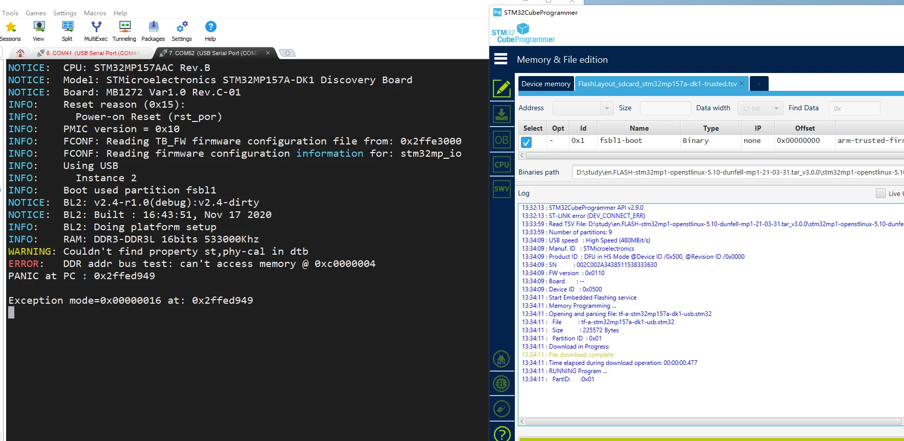

Hardware: STM32MP1-DK1 Software: Windows STM32Cube Programmer Question: Download hardware failed.
NOTICE: CPU: STM32MP157AAC Rev.B
NOTICE: Model: STMicroelectronics STM32MP157A-DK1 Discovery Board
NOTICE: Board: MB1272 Var1.0 Rev.C-01
INFO: Reset reason (0x15):
INFO: Power-on Reset (rst_por)
INFO: PMIC version = 0x10
INFO: FCONF: Reading TB_FW firmware configuration file from: 0x2ffe3000
INFO: FCONF: Reading firmware configuration information for: stm32mp_io
INFO: Using USB
INFO: Instance 2
INFO: Boot used partition fsbl1
NOTICE: BL2: v2.4-r1.0(debug):v2.4-dirty
NOTICE: BL2: Built : 16:43:51, Nov 17 2020
INFO: BL2: Doing platform setup
INFO: RAM: DDR3-DDR3L 16bits 533000Khz
WARNING: Couldn't find property st,phy-cal in dtb
ERROR: DDR addr bus test: can't access memory @ 0xc0000004
PANIC at PC : 0x2ffed949
Exception mode=0x00000016 at: 0x2ffed949
3 replies

李放.1
李放.1Author
Feb 15, 2022 05:36 UTC
v2.9.0 was also failed.
0693W00000JPoP7QAL.pngyes, i succeeded to program this board before.

Hello @�?� 放​  ,
Sorry for the late reply, it looks like an hardware issue.
This error when reading the DDR at 0xC000004 and the fact that it worked before let me think that.
  • Are you able to build your board normally or do you also encounter this error of DDR?
  • Do you have a second board to test if your setup and binaries works with the new one?
  • You can try to populate your SDCard manually by inserting it in a PC directly:
https://wiki.st.com/stm32mpu/wiki/How_to_populate_the_SD_card_with_dd_command#Populate_the_microSD_card_inserted_on_your_linux_host_PC_with_the_created_raw_file
And test if everything is ok without the download operation.
Regards,
Kévin
