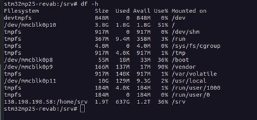

  • Extra note:
           Please use df command to check mount successfully or not.
         To un-mount volume on device:
          umount /srv
