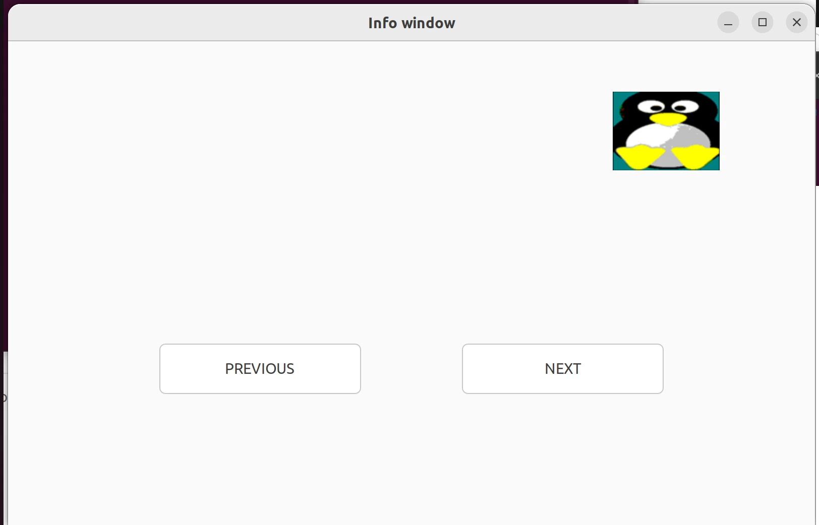

I am using STM32MP157C-DK2 board to create an application on the screen (using GTK library). My idea is to create a window with the following image inside:
0693W00000Y8tpkQAB.pngCreated code:

 image = gtk_image_new_from_file("linux.png");
 gtk_layout_put(GTK_LAYOUT(layout), image, 600, 50);

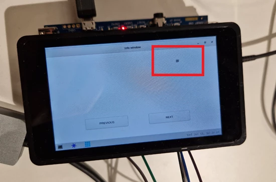

Then I have created executable using STM32CubeIDE and uploaded it with the image file (.png) in the following location:
  • /usr/local
Finally, I have run the GTK application with the following command:
Board $> su -l weston -c "/usr/local/custom_GTK"
Obtained result:0693W00000Y8tseQAB.pngDoes anyone know how I can display the image?

Hello @TArre.1​,
This kind of problem with GTK really let me think about a wrong path of your image. Try to mention the absolute path of the image (e.g. /usr/local/myimages/linux.png), or be careful to respect the right relative path of it.

TArre.1
TArre.1Author
Jan 23, 2023 15:34 UTC
Thank you @Erwan SZYMANSKI​ , with absolute path is working! :beaming_face_with_smiling_eyes:
