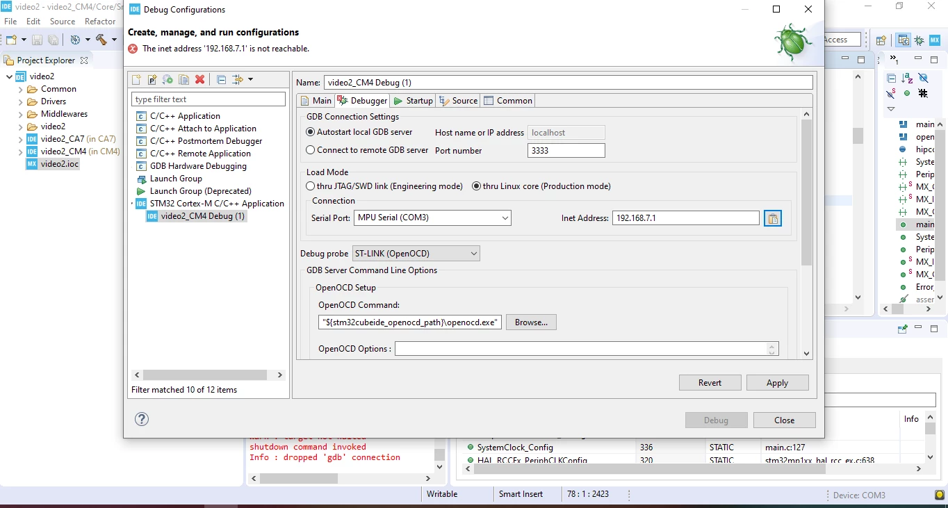

Good morning, thank you for your help. Found a problem. When you select Production mode, boot_0 boot_2 on, the CD card is installed, the debugger does not start debugging mode. С уважением, �?лек�?андр.

I see obvious message "target address not reachable" on top of the screenshot.
looks you try to use ethernet over usb connection with board. Need to connect USB cable on CN7.
Hope it help

Good morning. Thanks for the help. No I need to check eth0(cn8) I write > the ip addr add 192.168.1.4 dev eth0. Checking > ifconfig. The address is set. I > ping the static address I need. The result is the loss of all packets. How do I raise the eth0 interface? Sincerely, Alexander пн, 21 �?ент. 2020 г. в 17:34, ST Community :
