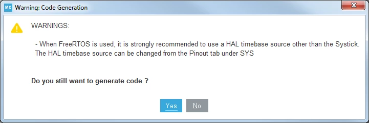

Hey, thx for that hint. I'm not using the Systick because of this warning.

Hello it's me again, i think there is a misunderstanding here. Because of the warning from CubeMX i'm using TIM7 as HAL timebase, not as a Systick for RTOS. The Systick for the RTOS is generated by the Systick-Timer. This is running perfectly in engineering mode, but in production mode it ends with the osErrorISR state when osKernelStart is called.

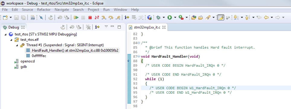

unfortunately, the patch can not fix the problem. The firmware with the patch behaves like i described in my last post. With the difference, that it chrashes in the hard fault interrupt. Is the firmware running in your development environment?

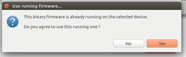

Please pay attention to the fact that when you load the image the second time in System Workbench, there is a popup window asking you the following,, ensure you answer "NO".

September 27, 2019
