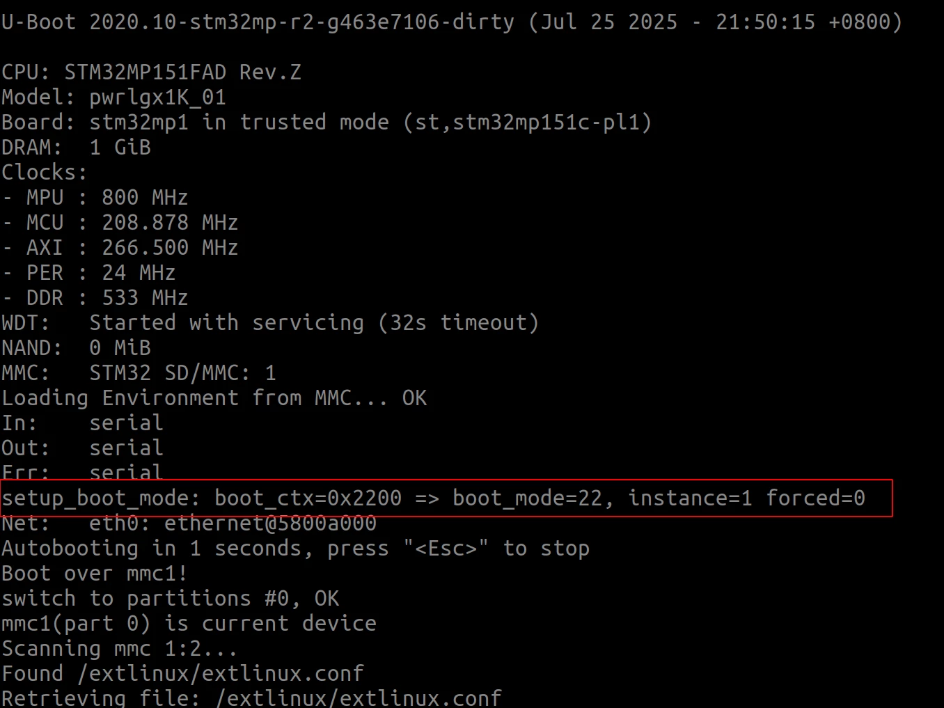

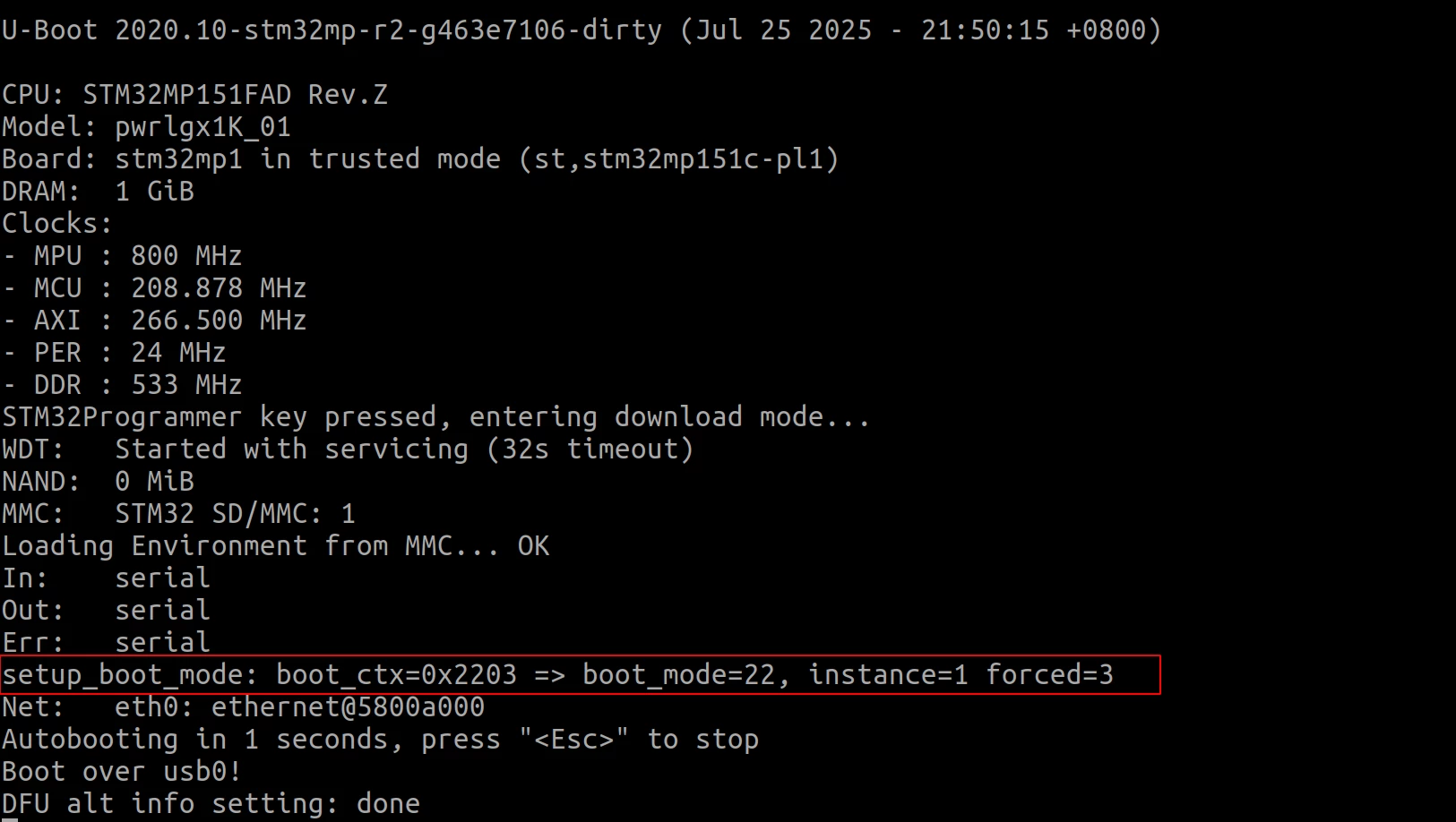

Hello ST team,
I came across issue here.
The force_mode of boot_ctx is always set to 3, which force the MPU to boot over USB, rather than MMC. I tried to set TAMP_BKP20R(BOOT MODE) to 0, but the behavior is the same after reset.
Aslo, I have another board (hardware is slightly different, but boot pin configuration is the same), which works well.
I know it can be fixed by changing UBOOT code. My questions are:
1. Is the value of this register boot_ctx set by ROM code?
2. The MPU model and version of the above two board are the same, STM32MP151FAD Rev.Z. Why is their behavoir different?

Hi @fantasylsdo
One assumption to check
May you properly delete the configuration of USER1 button in you DT ?
See description in LEDs and buttons on STM32 MPU boards - stm32mpu
Hope it help
Olivier
August 25, 2025
Hello Olivier,
Thanks for your reply. USER1 button is already deleted in our curret DT. It still doesn't work.
Regards,
fantasylsdo
