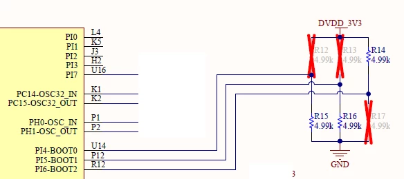

Regarding the interface between the MPU and the MMC - we're using a THGBMTG5D1LBAIL and it mostly matches the example in section 8.9 "eMMC Flash" of AN5474 except that it's connected in 4 bit mode (D4..D7 unconnected).
The boot pins on the MPU don't seem to match any of the connection examples:

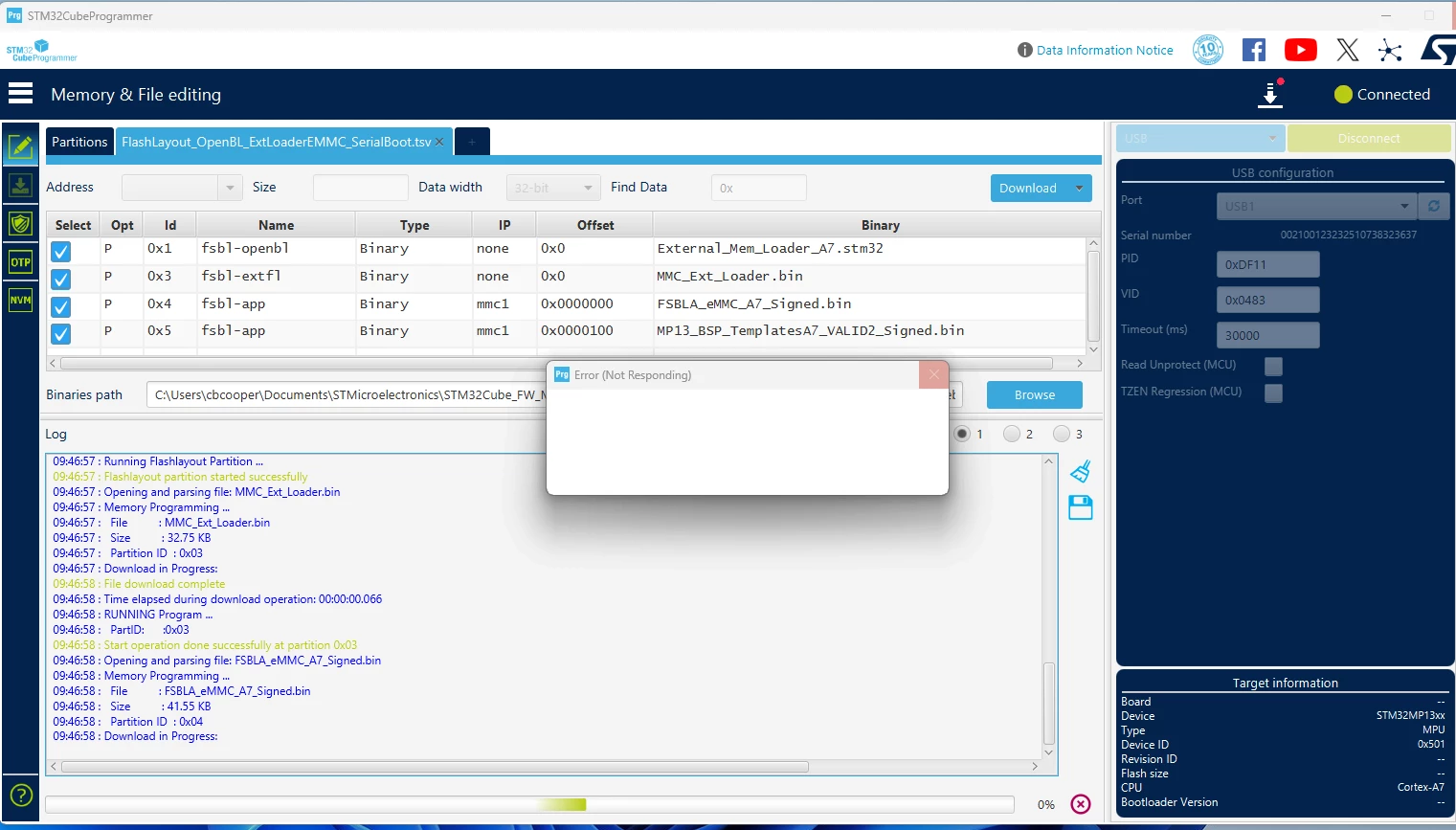

I learned that one of our EEs modified the board so it's now jumpered to serial boot mode (which is good).
But when I try to follow "How to load and start STM32CubeMP13 applications via eMMC storage" I run into a couple of problems.
First of all, that document says to "Select Binaries path with the Browse button: Firmware\Projects\STM32MP13XX_CUSTOM_HW\External_Loader\MMC_Ext_Loader" but if I do that and click Download, it gives the error "File does not exist: STM32Cube_FW_MP13_V1.2.0\Projects\STM32MP13XX_CUSTOM_HW\External_Loader\EMMC_Ext_Loader
\External_Mem_Loader_A7.stm32".
The correct path (I believe) is STM32Cube_FW_MP13_V1.2.0\Projects
\STM32MP13XX_CUSTOM_HW\External_Loader\Prebuild_Binaries\EMMC_Ext_Loader
But when I fix the path and click Download, it chugs for a while and then freezes:

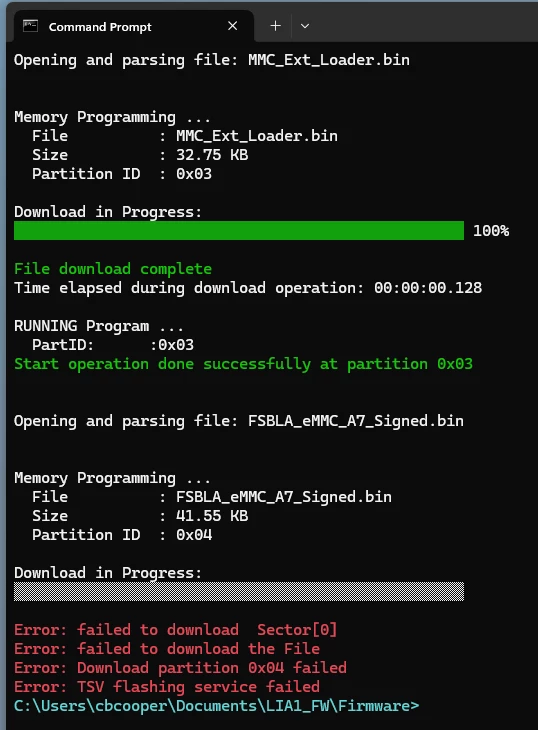

The command line version also failed, but at least gave an error:

ChatGPT thinks this failure is because "Some signed images (like FSBLA_eMMC_A7_Signed.bin) expect the chip to be in “boot from eMMC” mode to be written correctly" and my chip is in serial boot mode.
It says I should look for a “First Time eMMC Programming Guide” with a special FSBLA loader + configuration file.
