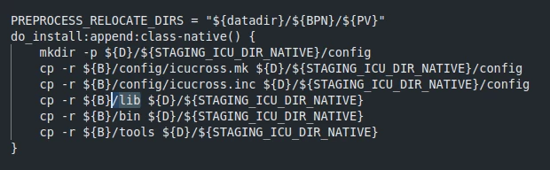

JJimé.2
JJimé.2Author
September 19, 2022
Hello @Gregory PLANCHON​,
I have tried removing the `/lib` from the icu_70.1.bb file, which is the one failing, but it failed with the same error again:0693W00000SvhFUQAZ.pngThat is the only appearance of `/lib` in the recipe. Do you know what I should look for?
Thank you.
