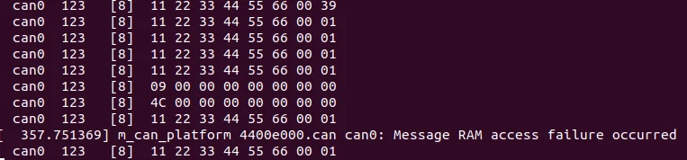

FDCAN Issues Memory Access
we are currently testing our FDCAN on our STM32MP157F Device. We get some Messages that there ist an access violation. We see that is caused by the M_RAF interrupt.
Are there any hints to get rid off these messages and errors?
We tried different settings with the message_ram config in the DT but with no success
