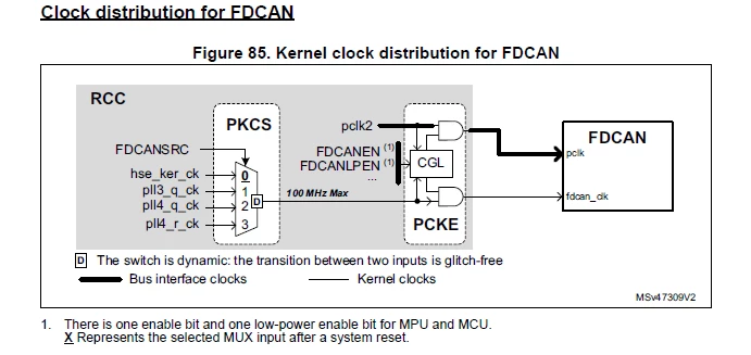

TArre.1
TArre.1Author
Dec 5, 2022 11:16 UTC
Hi @PatrickF​ , thank you for your reply!
I see that i have to enable the clock. In my case, I have connected the FDCAN1 to HSE as you can see in the image:
0693W00000WKDjRQAX.pngIn the main program, I think I have enable this with the PeriphCommonClock_Config program:
void PeriphCommonClock_Config(void)
 RCC_PeriphCLKInitTypeDef PeriphClkInit = {0};
 PeriphClkInit.PeriphClockSelection = RCC_PERIPHCLK_CKPER;
 PeriphClkInit.CkperClockSelection = RCC_CKPERCLKSOURCE_HSE;
 if (HAL_RCCEx_PeriphCLKConfig(&PeriphClkInit) != HAL_OK)
  Error_Handler();
Is something missing in my program or do I have to change something?
Thanks!
PatrickF
Dec 5, 2022 11:48 UTC
I assume you are in Development Boot mode, so HSE is not automatically started. Don't know if CubeMX generate the code for that (as in production mode, root clocks are managed by TF-A/uBoot/Linux).
Note that on DK2 board, the HSE should be started in 'digital bypass' mode.
I think you already checked that the FDCANEN bit in RCC is set.
Regards.
