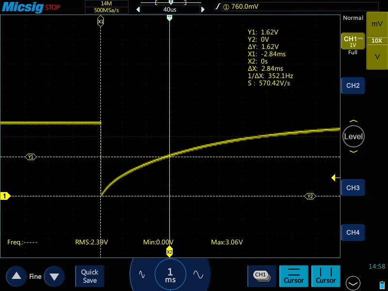

I'm having trouble resetting the board from linux.
Not using a PMIC but discrete power supplies.
I followed the app notes and errata, connecting the NRST and CORE_NRST pins with a cap then later a 0R resistor.
I'm using a single 100nF cap on NRST.
I can see the reset pin going down when rebooting from linux, unfortunately the MPU just freezes.
It looks like it gets stuck in BootROM after reset.
So far only a very long pull down (250ms+) on NRST works.
This or cycling power on VDDCORE which I can't do on my current prototype... (PWR_ON wired directly to VDDCORE supply enable pin)
Reset works fine from u-boot. (booting from SDMMC1, so already enabled)
I remember reset working a while ago, so I'll try to reproduce it and see what is blocking.
Any ideas?
NRST + CORE_NRST signals: (connected together)

I found the issue, it's caused by a circuit on my board: I use VBUS to control a transistor that pulls down some boot pins in order to upload firmware when plugged as a usb device.
There is a capacitor on VBUS that prevents this transistor to turn off fast enough until it reaches BootRom on reset.
