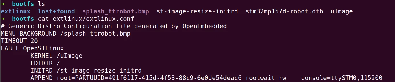

extlinux.conf can't chose uInitrd boot
hi st expert

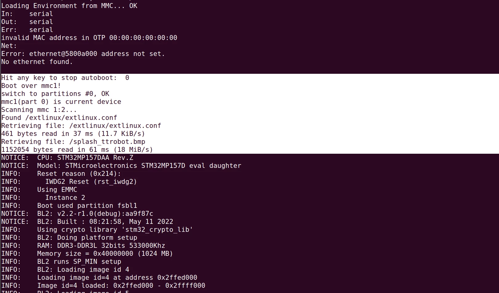

I am porting openstlinux for my robot board, I found that the system froze after uboot selected the extlinux file, and then rebooted after a while,the uart log :
0693W00000aIpSSQA0.pngDo I have any debugging means to analyze where the current problem is? thanks advance!
my extlinux.conf context:

its seens you are blocking when U-Boot try to display the splash screen
(it the last operation in the trace: extlinux is parsed, the bmp file is loaded and displayed)
and the Watchdog occur after 32s
it is the trace of 'Reset reason' in TF-A log = IWDG2 Reset
1/ to confirm, you can try to skip this splash screen step by removing the line
"MENU BACKGROUND /splash...." in the extlinux.conf file
2/ if it is confirmed, you need to debug the display configuration on your "robot board" in U-Boot
(device tree / Panel driver)
FYI: splash screen is displayed here for DISTRO boot with extlinux.conf
https://github.com/STMicroelectronics/u-boot/blob/v2021.10-stm32mp/cmd/pxe_utils.c#L1454
=> command cls + bmp_display()
you can activate debug trace (define DEBUG and LOG_DEBUG)
in the driver (DSI / LTDC ) and framework (DISPLAY U-Class) used for your panel on your board
https://wiki.st.com/stm32mpu/wiki/U-Boot_-_How_to_debug

Mar 16, 2023 15:23 UTC
hi PatrickD:
After remove "MENU BACKGROUND /splash...." in the extlinux.conf  kernel boot success, i'll try debug the display issue, thanks a lot!
