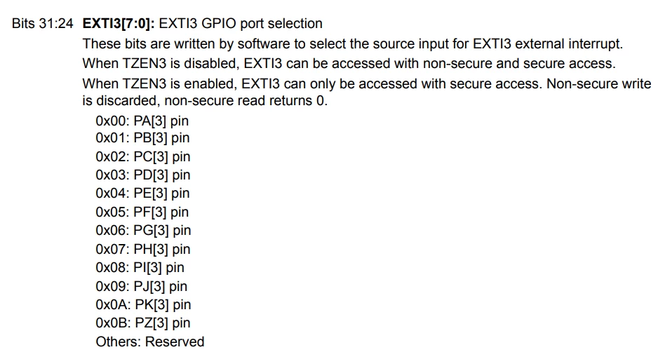

I have a interrupt conflict between two peripherals on pins PK7 and PI7. I am aware that these two end up on same EXTI7 interrupt mux, hence conflict in interrupt occurs. I am wondering if there is a way to separate these interrupts on different controllers perhaps? Re-designing the HW is not really possible or very hard at this stage

You cannot have an interrupt on PK7 and PI7 at the same time. This is a hardware limitation. Look at EXTI_EXTICR1 for the underlying hardware limitation. There is no solution which allows have GPIO pin interrupts on multiple ports for the same pin number.
