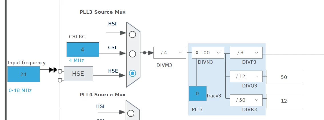

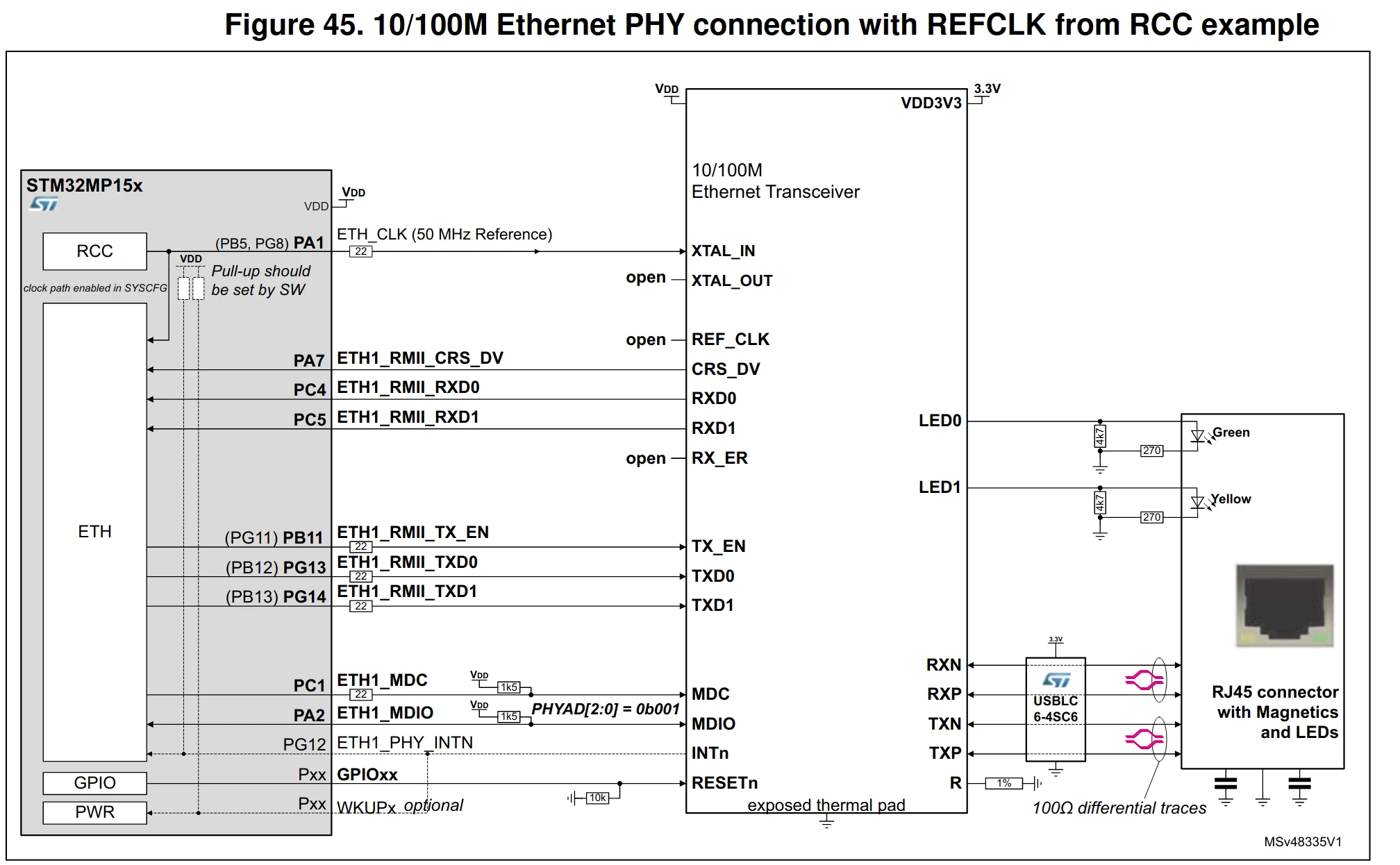

Example Device Tree Configuration for Ethernet with RMII mode with Reference Clock (STM32MP15).
I have the connection on the image from AN5031 for my custom board and I my clock configuration can be seen on the other picture. Is my clock configuration correct and how its device tree code should be?0693W00000SvZE4QAN.png0693W00000SvZDzQAN.png0693W00000SvZDaQAN.png

Hi @Gencay​
please have a look to
https://wiki.st.com/stm32mpu/wiki/Ethernet_device_tree_configuration#RMII_with_50MHz_on_ETH_CLK_-28no_PHY_Crystal-29-2C_internal_REF_CLK_from_RCC_-28Reference_clock_-28standard_RMII_clock_name-29_is_provided_by_a_RCC_SoC_internal_clock-29
