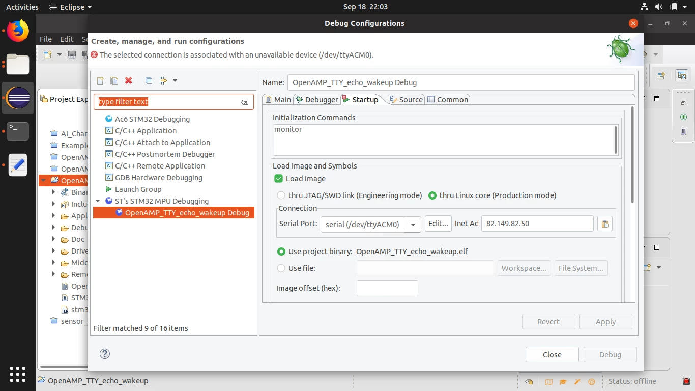

IYetk
Sep 18, 2019 8:10 PM UTC
I got the same error like you but I couldn't solve the problem so far. How did you switch between engineering boot mode and production boot mode ? Do you mean the eclipse debug configuration tab in the attachment ?
other question : Our scenario is the second scenario in the readme file. There it says "Set Exti line 61 (IPCC interrupt CPU1) as source of wakeup". So I modified the code and changed 62 to 61 and some other lines related. Did you modify your code as well ? If yes, could you please send me modified codes if possible.
I will appricate a possible answer very muc, thanks a lot !
PatrickF
Sep 19, 2019 6:29 AM UTC
Engineering mode set in SW4STM32 should be also set on the board using BOOT[2:0] = 0b100
In order to give better visibility on the answered topics, please click on 'Best Answer' on the reply which solved your issue or answered your question.Tip of the day: Try Sidekick STM32 AI agent

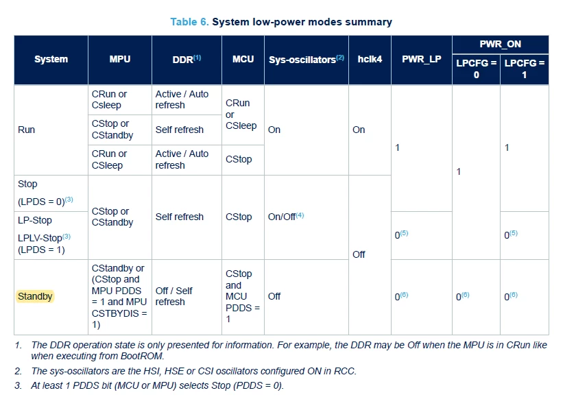

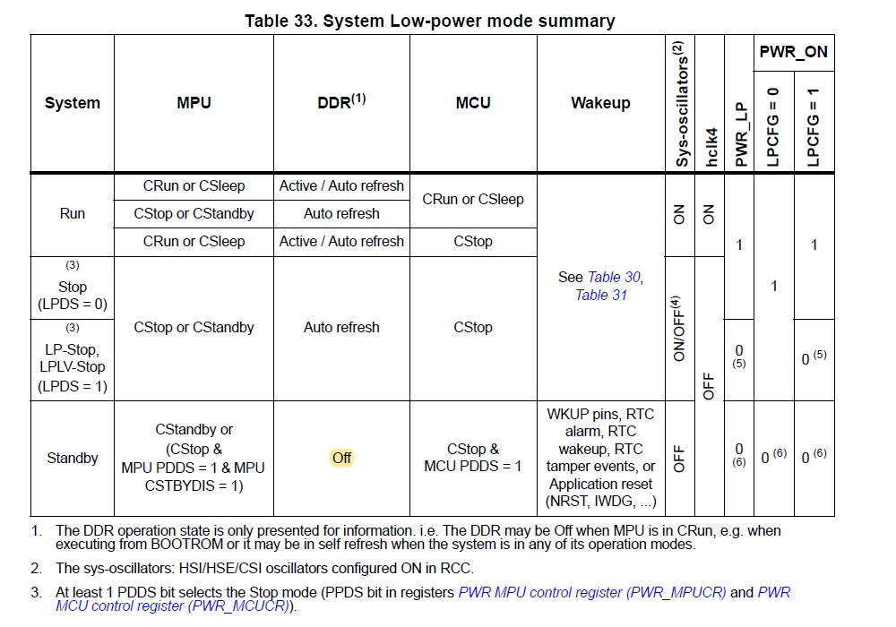

Thank you very much for your answer. I'm still a beginner for low power mode and linux kernel, so I'm sorry that I have so many questions to ask.
1.The Table 33 in doc STM32MP157xxx reference manual RM0436.pdf mentions that DDR is off in System Standby Mode:
However, if DDR is off, the platform must be reboot after wakeup. But in the doc  AN5109 low power application note , Figure 7 shows that DDR isn't off, the Table 6 shows that the DDR status is off or self refresh:
So what is the true state of DDR?

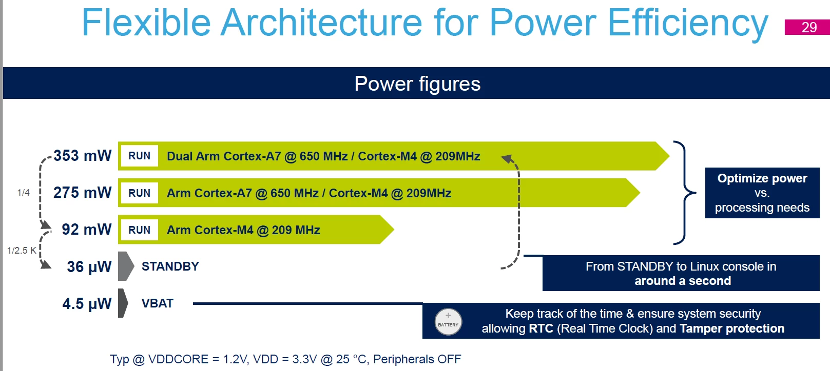

2.How do you define the Wakeup Time after exiting from System Standby Mode? The ppt STM32MP1 Microprocessor - Continuing the STM32 Success Story mentions the wakeup time is around 1 second,
But if I count all the log time after pressing the wakeup button, it's more than 2s.

So how do you define the time from Standby to linux console?
3.My log info and reboot phenomenon is different from your second suggestion -- stop weston,go to standby ,wakeup and start weston , so I’m confusing that whether I did enter the System Standby Mode actually by using the "systemctl suspend" command.
Is there any way to judge it? The log information in the log of my question 2 shows as follows:
INFO: Reset reason (0x810):
INFO: System exits from STANDBY
can it prove that I did enter the standby mode? Or can I judge by testing the value of Vddcore ? Do you have any suggestions?
Thanks a lot!

1/ in Standby mode, you have the choice to switch off the ddr or to keep it in self refresh "SR" (both are supported).
  • The advantage of going in DDR SR is that you will wake up more rapidely (Linux running context is saved then you have to switch on the devices, the clocks and jump into where you were in linux before going to run state (TF-A is mainly doing this jog).
  • The drawback of going in DDR SR is the power consumption of this DDR mode (typically 10mW for a lpddr2).
  • The drawback of going in DDR off is that you will need a complete reboot (so you lose your system context (if not saved in backup RAM) and your wake up time will be longer.
2/ 1 sec for standby wake up is what is achievable for a final product. We already confirmed this value customizing a bit the SW on DK2. DK2 standard delivery is a development platform so not optimized for power (even if all the power mechanisms are present and can be experienced). For example, full debug is activated and almost all the peripherals.
A wiki page is under construction to show how to reach better power results with ST boards.
