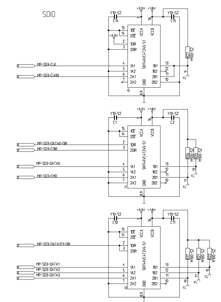

Error initializing wifi module with SDIO and voltage translation
Hello all,
I'm getting following error on our custom board while initializing sdmmc3 as wifi module with SDIO:
~# dmesg | grep -i sdio -B 1
[ 3.410271] mmci-pl18x 48004000.sdmmc: no support for card's volts
[ 3.415001] mmc0: error -22 whilst initialising SDIO card
[ 5.298030] mmci-pl18x 48004000.sdmmc: no support for card's volts
[ 5.302938] mmc0: error -22 whilst initialising SDIO card
[ 7.140215] mmci-pl18x 48004000.sdmmc: no support for card's volts
[ 7.144982] mmc0: error -22 whilst initialising SDIO card
[ 8.930932] mmci-pl18x 48004000.sdmmc: no support for card's volts
[ 8.935676] mmc0: error -22 whilst initialising SDIO card
Wifi module is a ST60-2230C (https://www.lairdconnect.com/documentation/datasheet-st60-2230c) with I/O signalling voltage 1V8.
Between STM32MP and ST60 module there are three voltage translators which translate 3V3 (STM32MP) to 1V8 (ST-60). See attached schematics snippet.

Can I configure STM32MP to use 1V8 I/O signalling? Or any other solutions?
Thanks for help!

I'm not sure this setting will work, I'm not expert of this driver, but I hope driver is generic enough.
Did you cross check the level translator you used are using correct _DIR defaut polarity, i.e. 0 = Card -> MPU input , 1 = MPU output -> Card.
Check if this is missing
 st,sig-dir;
not sure if also
vqmmc-supply = <&xxxx>;
is required in your case.
see https://wiki.st.com/stm32mpu/wiki/SDMMC_device_tree_configuration

Jul 7, 2021 08:21 UTC
Thanks @PatrickF​ .
st,sig-dir;
did the trick.
My wifi module works!
Many thanks for fast & good answer!
