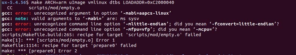

Next issue......
when running make ARCH=arm uImage vmlinux dtbs LOADADDR=0xC2000040
 WRAP   arch/arm/include/generated/asm/trace_clock.h
 WRAP   arch/arm/include/generated/asm/simd.h
 UPD    include/config/kernel.release
 UPD    include/generated/uapi/linux/version.h
 UPD    include/generated/utsrelease.h
 SYSNR  arch/arm/include/generated/asm/unistd-nr.h
 GEN    arch/arm/include/generated/asm/mach-types.h
 SYSTBL arch/arm/include/generated/calls-oabi.S
 SYSTBL arch/arm/include/generated/calls-eabi.S
 CC     scripts/mod/empty.o
gcc: error: unrecognized argument in option ‘-mabi=aapcs-linux’
gcc: note: valid arguments to ‘-mabi=’ are: ms sysv
gcc: error: unrecognized command line option ‘-mlittle-endian’; did you mean ‘-fconvert=little-endian’?
gcc: error: unrecognized command line option ‘-mfpu=vfp’; did you mean ‘-mcpu=’?
scripts/Makefile.build:265: recipe for target 'scripts/mod/empty.o' failed
make[1]: *** [scripts/mod/empty.o] Error 1
Makefile:1110: recipe for target 'prepare0' failed
make: *** [prepare0] Error 2
Thank you by advance for any help.

Olivier GALLIEN
Olivier GALLIENBest answer
Nov 13, 2020 07:51 UTC
Hi @Sisyphus38​
Open a new shell and source again the SDK.
If one of my comments answer your need, please mark it "Best answer"
Olivier
Sisyphus38
Nov 13, 2020 09:38 UTC
Hello Olivier,
You right. When I source again all env variables are retrieved and the "Hello world" compile again !
I launched make ARCH=arm uImage vmlinux dtbs LOADADDR=0xC2000040 and compiling is still proceeding .
Good signal !
Thank you again Olivier.

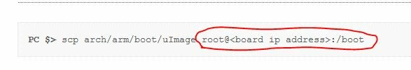

Hi @Community member​ I was unable to connect my pc to the board using ethernet, because of IP differences. Resolving between IPv4 and IPv6 has become too complicated for me since the board has no editor that I can use to edit the files indicated at the link you provided; in future I will use a router between my pc and the board, but I need this problem to be solved now before I get the router. My work around was by copying to a USB memory stick all files that were supposed to be sent by the command
PC $> scp arch/arm/boot/dts/stm32mp157*.dtb root@<board ip address>:/boot
in Section 5.2 here Modify, rebuild and reload the Linux® kernel - stm32mpu and transfer them to the board manually.

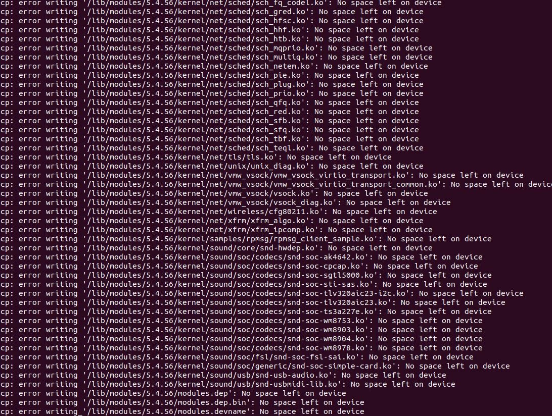

0693W000007CWOMQA4.jpgIf I ignore that error and proceed by copying all files intended by the command
PC $> scp -r install_artifact/lib/modules/* root@<ip of board>:/lib/modules
then I run into memory problems where many modules of the kernel cannot be installed because of insufficient space as shown below.
0693W000007CWVNQA4.jpgDo you have any ideas to go around it? Please @Community member​ and @Sisyphus38​ help with your expertise and experience with this board
