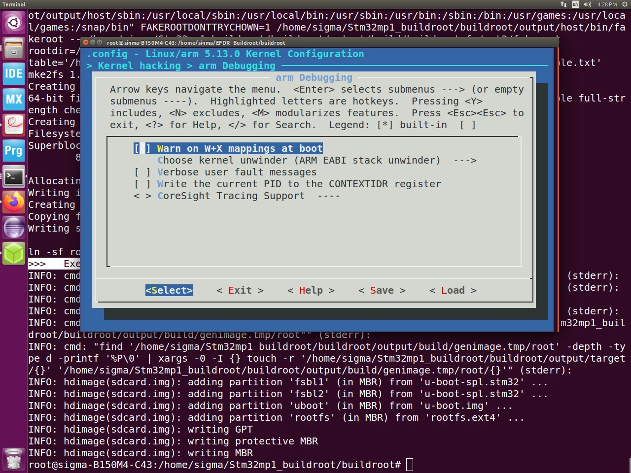

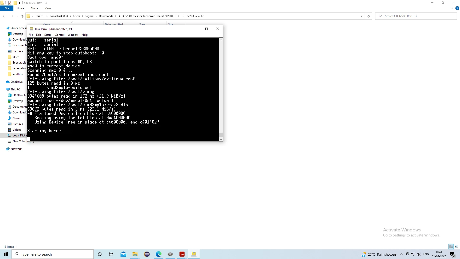

We are using stm32mp157a-dk1 board.So we want to change the default console serial port(UART4) to anthour serial port(UART 7). I have changed respective .dts files in uboot it is working properly up to uboot.Know i want to change in kernal.
So i Refereed St wiki.They said that we need to enable to CONFIG_DEBUG_LL, CONFIG_STM32MP1_DEBUG_UART and CONFIG_EARLY_PRINTK using the Linux Menuconfig.
Refer below link for your reference
https://wiki.st.com/stm32mpu/wiki/Dmesg_and_Linux_kernel_log#earlyprintk
I am unable to active those configurations through linux menuconfig. I am using linux-5.13 version. How can i activate CONFIG_DEBUG_LL, CONFIG_STM32MP1_DEBUG_UART and CONFIG_EARLY_PRINTK?
I am attaching my screenshots for linux-menuconfig and my uboot log.
could you please help us in this regards.

Hi @Sindhu Vadde​
Don't know it this is the root cause, but Kernel 5.13 is not supported by OpenSTLinux ecosystem, it is either 5.10 with Ecosystem 3.x or 5.15 with Ecosystem 4.x .
