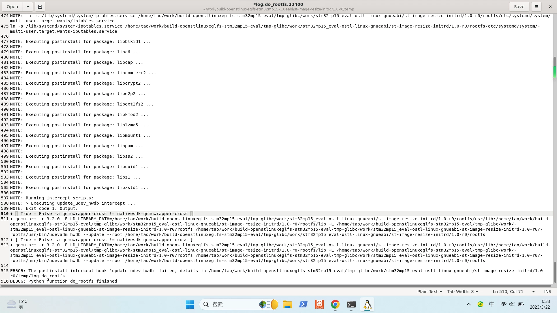

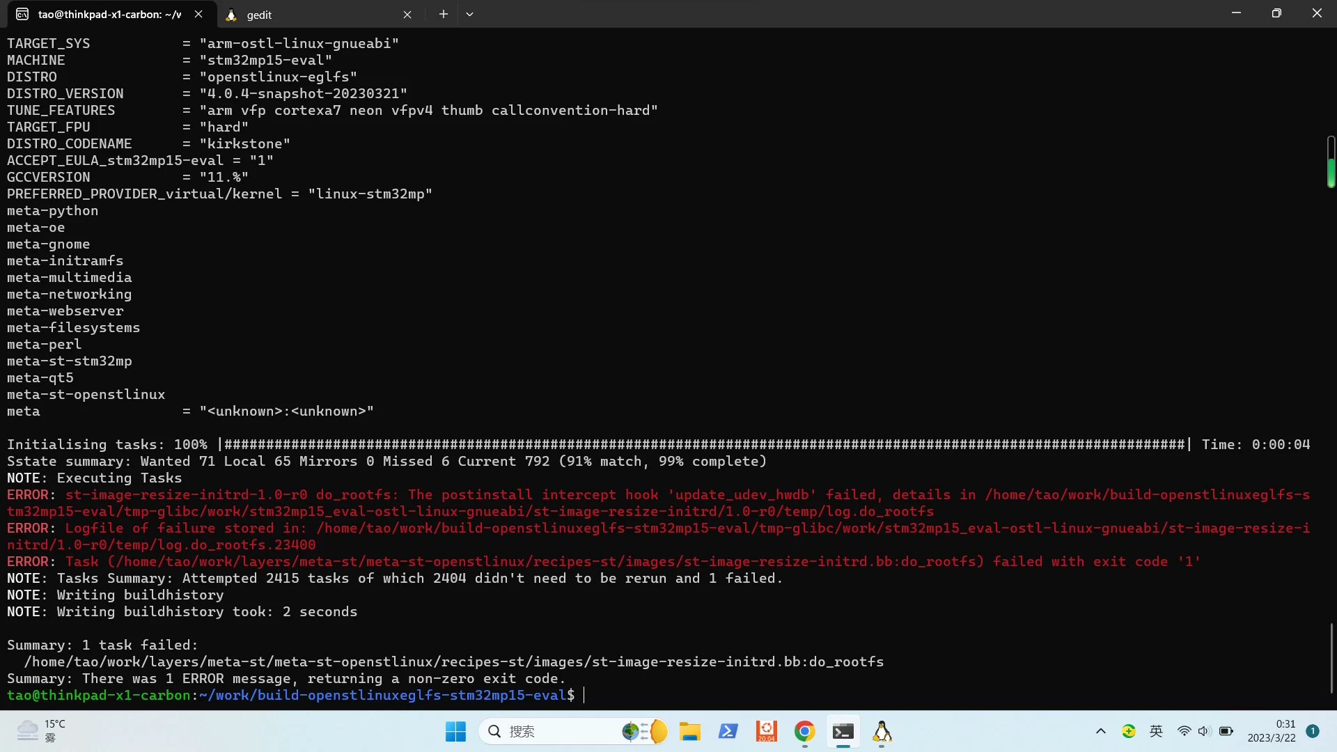

hi st expert:
I'm updating my yocto version to Ecosystem V4.1.0, but I can not compile suceess in wsl ubuntu20.04, this is error log:
0693W00000aJQQWQA4.pnglog.do_rootfs.23400 as follew:
0693W00000aJQQlQAO.pngHow should this problem be solved? thanks

Hello @ttao.1​ ,
Ok good news that at least, you were able to boot.
The WSl way is possible, but it is still experimental as explained in the wiki: https://wiki.st.com/stm32mpu/wiki/PC_prerequisites#WSL2_-28experimental-29
We recommend to use a real Linux environment for the build.

I have complied  new yocto successful in ubuntu host and gave up compliing with WSL.
