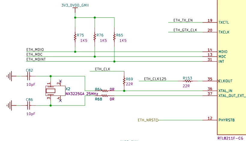

I am currently working on the STM32P157 to RTL8211F-CG connection diagram using the RGMII interface. Since Realtek does not provide much documentation such as application notes, I used the MB1272C as a reference design. By the way, thanks for sharing. In the mentioned reference design, pin 36 (XTALL_IN) of the RTL8211F-CG is connected via a 22R resistor to port PB5 (ETH_CLK) of the STM32P157 processor.

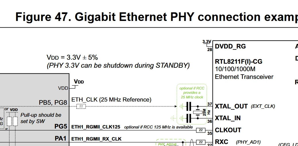

However, in AN5031, on page 74 (Figure 47), ETH_CLK is connected to pin 37 (XTALL_OUT) of the RTL8211F(I)-CG. Also in RM0436 on page 503 in Table 49, ETH_CLK is as a clock output for the Ethernet PHY.

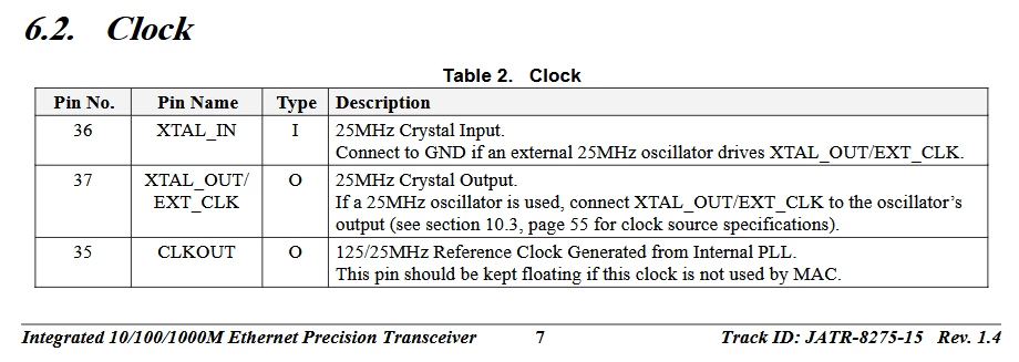

However, in the RTL8211F-CG note, pin 37 is described as XTAL_OUT/EXT_CLK, theoretically a clock input, but the pin is marked as output.
I am a bit confused,did I miss something? I do not know now whether I should connect the ETH_CLK output to XTALL_IN or XTALL_OUT, common sense tells me that the output is connected to the input, but...
Thanks for any sugestions.

I agree the possible connection of a 25MHz clock to RTL8211F is wrong on the MB1272 board (this option is anyway not used, R69 is not soldered).
ETH_CLK 25MHz is only used when you want to get rid of the 25MHz crystal.
Maybe you could refer to AN5031 which give slightly more details around RTL8211F clocking options.
