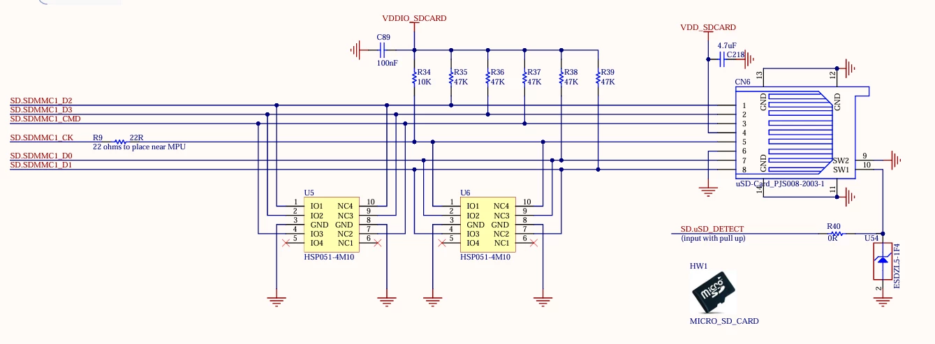

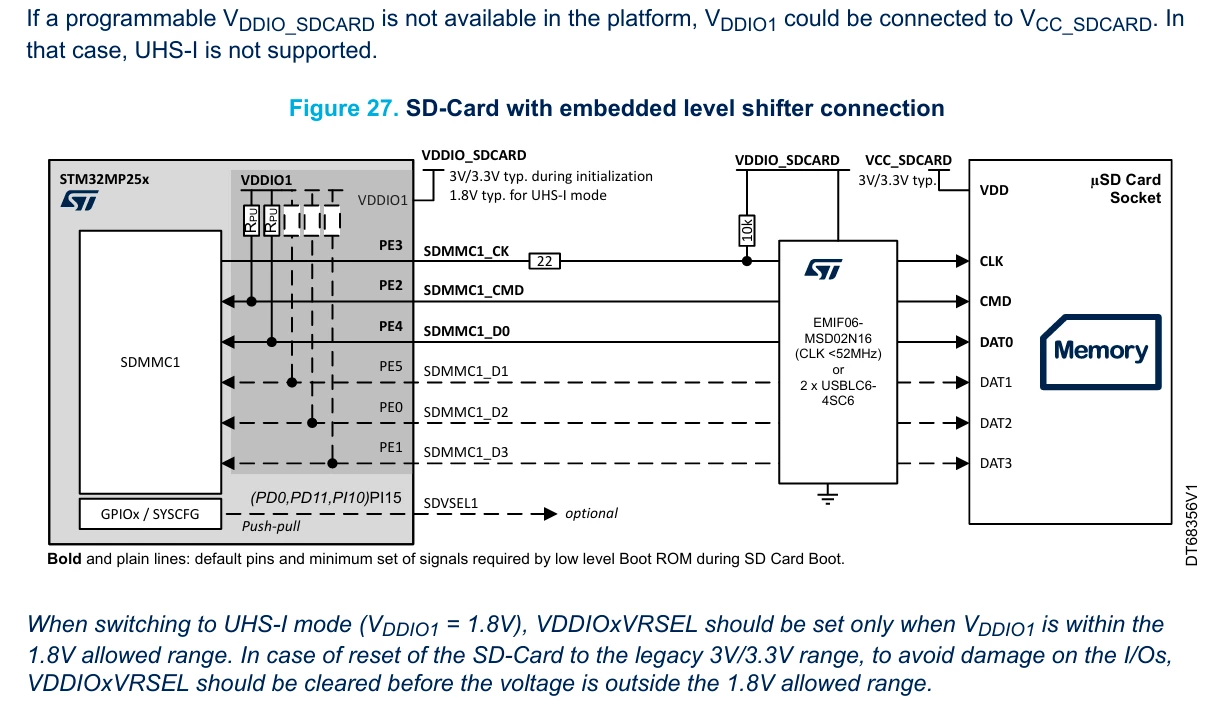

Does the sdmmc1 I/O have internal pull-ups on CMD, D0 D1, D2 and D3?
I’m reading the getting started manual of STM32MP257 (AN5489) and it displays that there are internal pull-ups on
CMD and D0, but not CK.
Also there is a confusion if the dashed lines means they have internal pull-ups as well.
My question is:
If CMD, D0, D1, D2 and D3 have internal pull-ups. Why does the STM32MP257F-DK board have external pull-ups?
Can I skip these external pull-ups?
According to the datasheet of STM32MP257C/F (DS14284 - Rev 5), the CK, CMD and D0 MUST be high at initialisation of the BootROM.

Thank you ​@PatrickF  for your reply.
This concludes:
- CLK have a external pull-up just to avoid making it floating before BootROM
- When BootROM loads, then CLK, CMD, D0, D1, D2 and D3 will get their internal pull-ups activated
- A serie resistor on CLK, near MPU, is good to have only. Even if it's quite unecessary for short traces (less than 30 mm)
- I don't have any vias on my traces (except for the CLK for pull-up
- No external pull-up ups are necessary for CMD, D0, D1, D2 and D3.
- External pull-ups of 10-100 kOhm will not have any impact on signal integrity (except if there is a large T connector for the pull-ups e.g long trace)
So what I will do is that I going to
- Add back the 22 ohm serie resistor for CLK
- Add a 10 kOhm pull-up after the 22 ohm resistor onto the pad (via-in-pad)
What I'm want to inform you is that the getting started manual AN5489 have not correct information at the figure 27. It missing some pull-ups (only blank squares) and the the CLK line is totally missing a pull-up as well.

I know that weak internal pull-ups have a less quality compered to e.g. 0402 external pull-ups.
But! Here is the catch.
At the current moment, I’m using the ST product EMI-filter EMIF06-MSD02N16, which have internal pull-ups. That’s great! But unfortunately the EMI-filter EMIF06-MSD02N16 only works for SDR50 SD-cards and below. These days SDR50 is very rareware and difficult to buy because the successor SDR104 is the current standard.
The only ST product for an EMI-filter that can handle SDR104 is EMIF06-HSD03F3. Unfortunately, the EMI-filter EMIF06-HSD03F3 does not have internal pull-ups as EMIF06-MSD02N16 does.
Answer: You could switch on internal pullups, but these are about 40k , so maybe not optimum.
Reply: Yes! But the internal pull-ups of EMIF06-MSD02N16 is 80 to 100 kOhm, which is more. I have tested the EMIF06-MSD02N16 with STM32MP257F on a custom board. It works if you make sure that the SD-card clock is limited to 50 MHz only. Over that limit, then you will get kernel panic after the linux kernel has been loaded.
Answer: Internal pull-up resistors are typically weak (ranging between 30 kΩ and 50 kΩ). The SD Association specifications mandate much stronger pull-ups (typically 10 kΩ) on data/command lines to ensure clean signal integrity, especially at higher clock speeds (e.g., High-Speed or UHS modes).
Reply: Do you have a documentation for that? Because most of the EMI-filters for SD-card does not have pull-ups. Having external pull-ups for a high speed signal SDR104 (208 MHz) is very critical and needs to be routed correctly.
Answer: At initial power-up (before the internal pull-ups are initialized by software), the lines will float, which can lead to erratic behavior or prevent the SD card from being properly detected.
Reply: Yes, I am aware of that. But I’m not sure that these pull-ups will float, because they are all connected to VDDIO1. I hope any ST Dev Team and explain more about this.
Answer: So saving some cent seems no clever decision here. Just follow the DK board design.
Reply: No, the STM32MP257F-DK board design contains lots of obsolete components and bad components. Also the routing is exepnsive for the purpose. I think ST should update their BOM-list and some components inside the STM32MP257F-DK.
