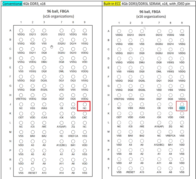

Does STM32MP153 and STM32MP157 support ECC for RAM interface ( DDR3)?

I'd like to comment about ECC DDR3. This device can be used with standard SoC.
Please see below example based on Zentel Japan PN A3T4GF40CBF, 4Gb Built-in ECC DDR3/DDR3L SDRAM:
The ECC is a built-in function, the product has the features listed below
  • /DED (Double bit Error Detection) pin sends a fault detection signal to notify SoC of memory data error
  • Compatible with conventional JEDEC standard DRAM;
  • /DED pin is connected or unconnected does not affect ECC function;
  • /DED pin state or level does not affect ECC function
  • Note : Use Burst Chop and Data Mask may restrict the ECC functionality
Note:
  • /DED pin should be terminated at the VTTD and will be output low level when DED occurs.
  • If you do not use the DED notification, please fix /DED to VSS or OPEN.

Hi @ABala.7​
There is no support of DDR ECC on STM32MP1 products.
Regards,
