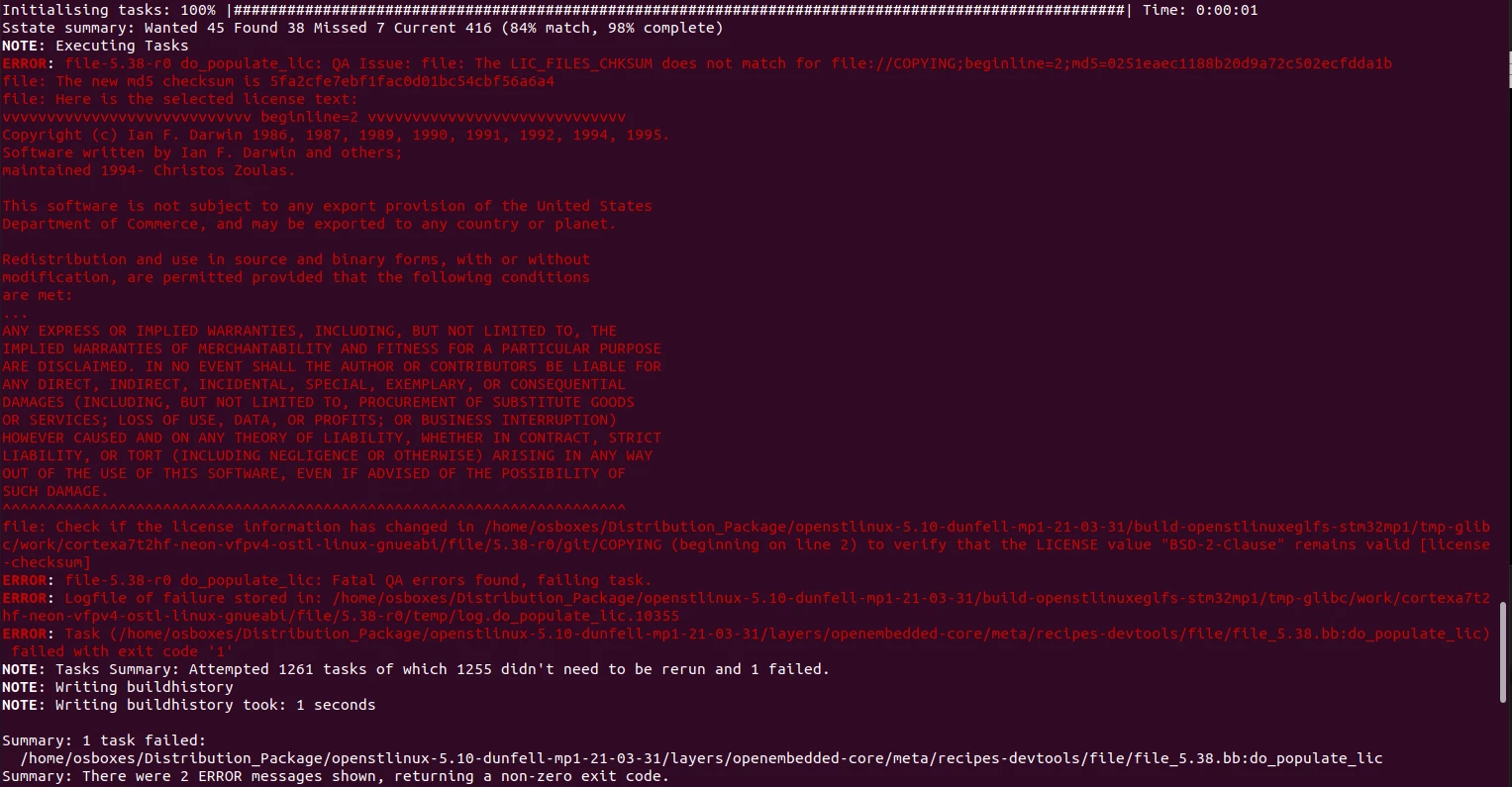

I have an issue while building the Distribution Package. I have created a new layer and tried to add different programs with CORE_IMAGE_BASE_INSTALL_append. I have succeeded to add programs like python3, wvdial, etc. I also want to add nano and networkmanager but I get these errors:

I understand that. I haven't made any changes to the file that is mentioned in the error-log. I have tried to change the checksum to the suggested one but it still doesn't work.
This is what I have done:
I changed the LIC_FILE_CHKSUM in /Distribution_Package/openstlinux-5.10-dunfell-mp1-21-03-31/layers/openembedded-core/meta/recipes-devtools/file/file_5.38.bb line 9, from md5=0251eaec1188b20d9a72c502ecfdda1b to md5=5fa2cfe7ebf1fac0d01bc54cbf56a6a4
I attach a screenshot of the error.

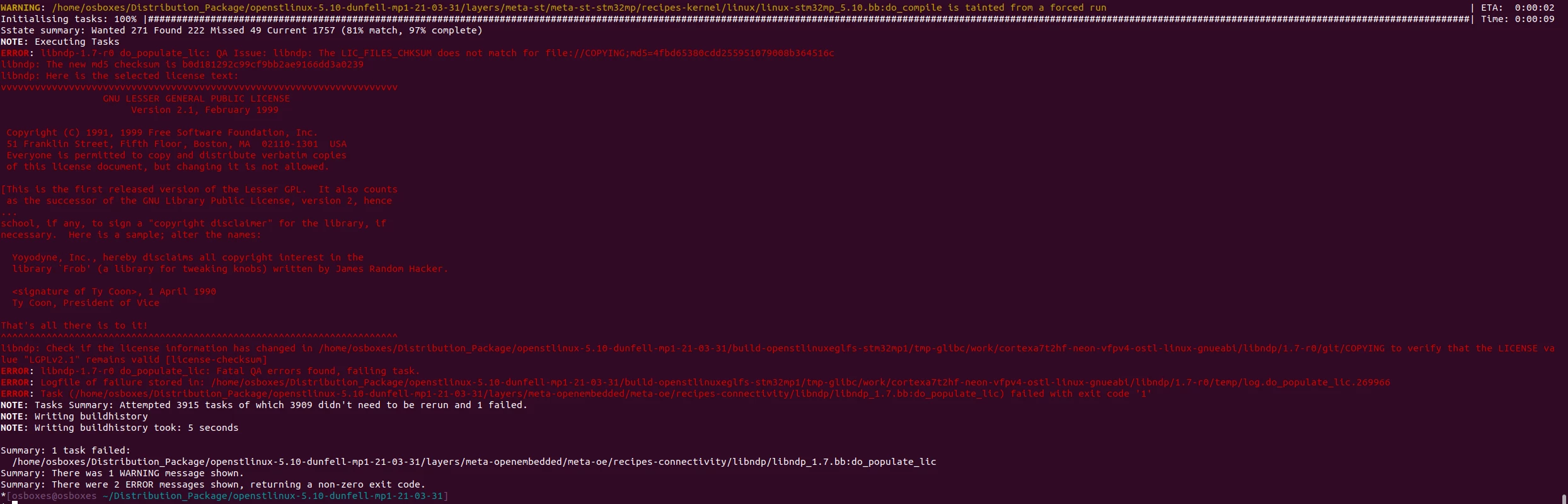

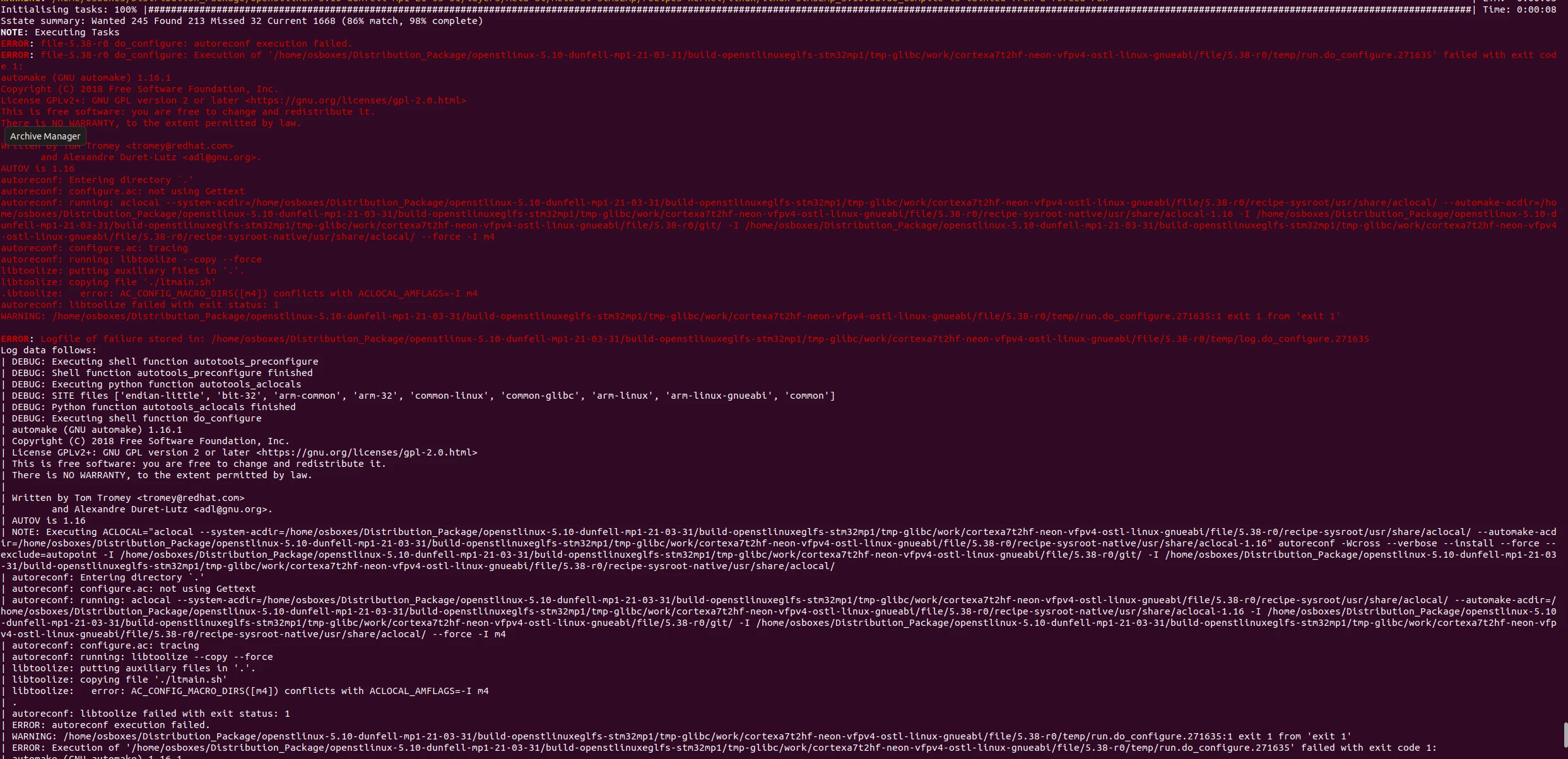

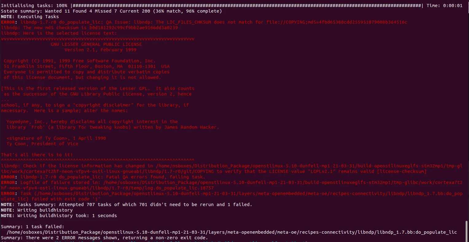

Unfortunately, it didn't work. I did the cleansstate first and took screenshots of the errors while trying to bitbake file and libndp:0693W00000DmeI3QAJ.png0693W00000DmeFjQAJ.pngBest regards,

Same thing for the GIT repository of libndp: it gives me the expected checksum. So could you check your recipe libndp_1.7.bb in layers/openembedded-core/meta/recipes-connectivity/libndp shows the line
SRCREV = "96674e7d4f4d569c2c961e865cc16152dfab5f09"
