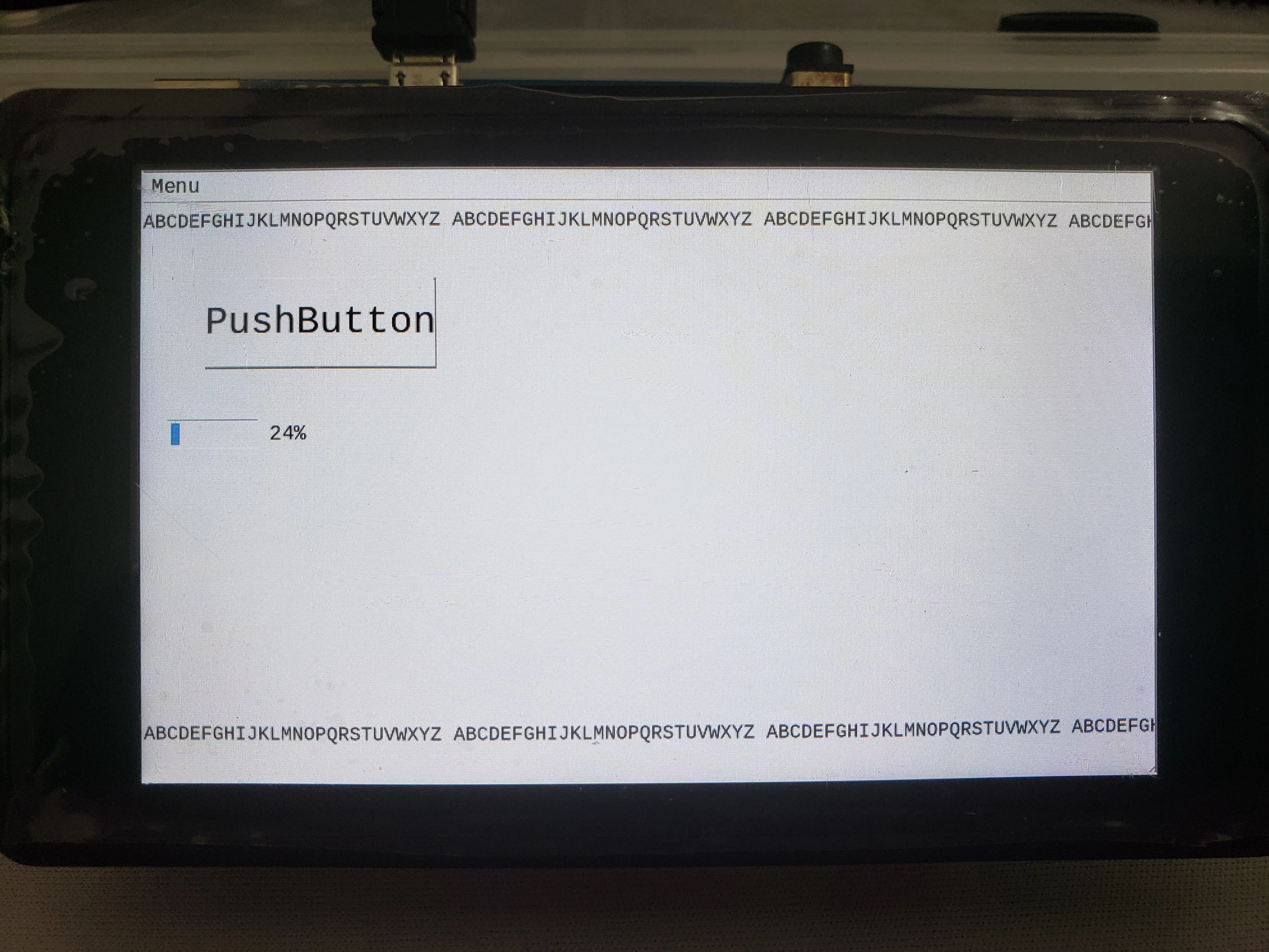

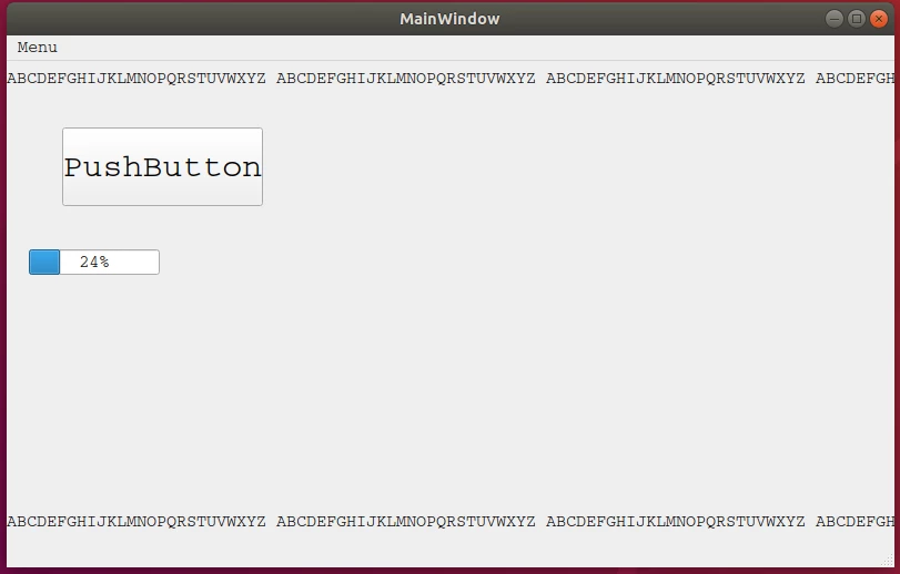

I made a simple widget example with label but the font size in STM32MP157C-DK2 is biggest than Ubuntu PC. How can I fix this?

I found one way to fix it but I don't know if is the best.
Does anyone knows how to config the pixel size on Qt?
Thank you for any help!
Follow the solution I used:
#define ADJUST_PIXEL_SIZE_FOR_STM32MP1 1.4
MainWindow::MainWindow(QWidget *parent)
 : QMainWindow(parent)
 , ui(new Ui::MainWindow)
 ui->setupUi(this);
 QFont font;
 font = ui->label->font();
 font.setPixelSize(font.pointSize() * ADJUST_PIXEL_SIZE_FOR_STM32MP1);
 ui->label->setFont(font);
 font = ui->label_2->font();
 ui->label_2->setFont(font);
 font = ui->pushButton->font();
 ui->pushButton->setFont(font);
