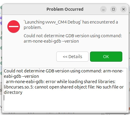

I am trying to debug a code using STM32CubeIDE on Ubuntu with the STM32MP157F-DK2. However, I am encountering the following problemScreenshot from 2024-05-20 08-44-59.png

Is this your first try to debug anything ? did it work before ?
Seems the libncurses is missing, look : is it in your system ?
(in my Linux its in : /lib/i386-linux-gnu/libncurses.so.5 )
May 20, 2024 08:56 UTC
This is my first time using this system, and yes, I have installed libncurses5

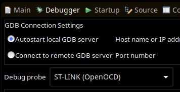

So i dont know...
just try: use OCD debug
