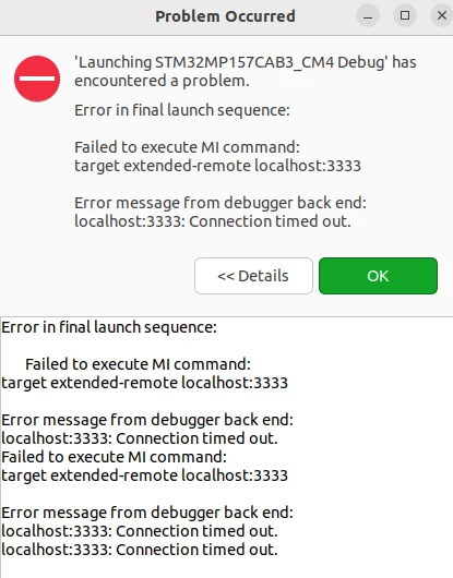

we're trying to debug an STM32 image (kernel-version V6.1.28) on the M4 core using STLINK-V3SET debugger via STM32CubeIDE (V1.16.0) and getting the following error:
Error in final launch sequence: Failed pre launch (s. attached screenshot).
The directory /lib/firmware has space and is writeable.
Does anyone have an idea what the problem is?

create the folder /lib/firmware by hand. STM32CubeIDE obviously expects it in the file system and is not able to create it by itself if it is not available.

When I create this folder manually I get the new error: "Failed to execute MI command":
UStei.1
Oct 29, 2024 4:11 PM UTC
it seems that the openocd server cannot be started correctly. The console output shows:
Open On-Chip Debugger 0.12.0+dev-00597-ga5a21219f (2024-06-03-11:02) [https://github.com/STMicroelectronics/OpenOCD]

Error: init mode failed (unable to connect to the target)
when I add the -d option into the command line, it shows that it fails caused by an USB error:

Hello @BuGe @UStei.1 and @DStau.1 ,
Did you follow steps of the following Wiki page?
If yes, could you please confirm that you had the same settings and are still unable to open a debug session?
because I'm able to establish connection with CubeIDE 1.15.1 and latest image version available stm32mp1-openstlinux-6.1-yocto-mickledore-mpu-v24.06.26 following the steps in the mentioned above Wiki page.

yes I know this Wiki of course and have the same settings. The only thing I changed was setting the interface from SWD to JTAG, because my baseboard provides only a parallel JTAG connector.
Obviously, you changed the debug probe field from OpenOCD to GDB server. Doing that here, I get the following  log file attached (st-link_gdbserver_log.txt)
