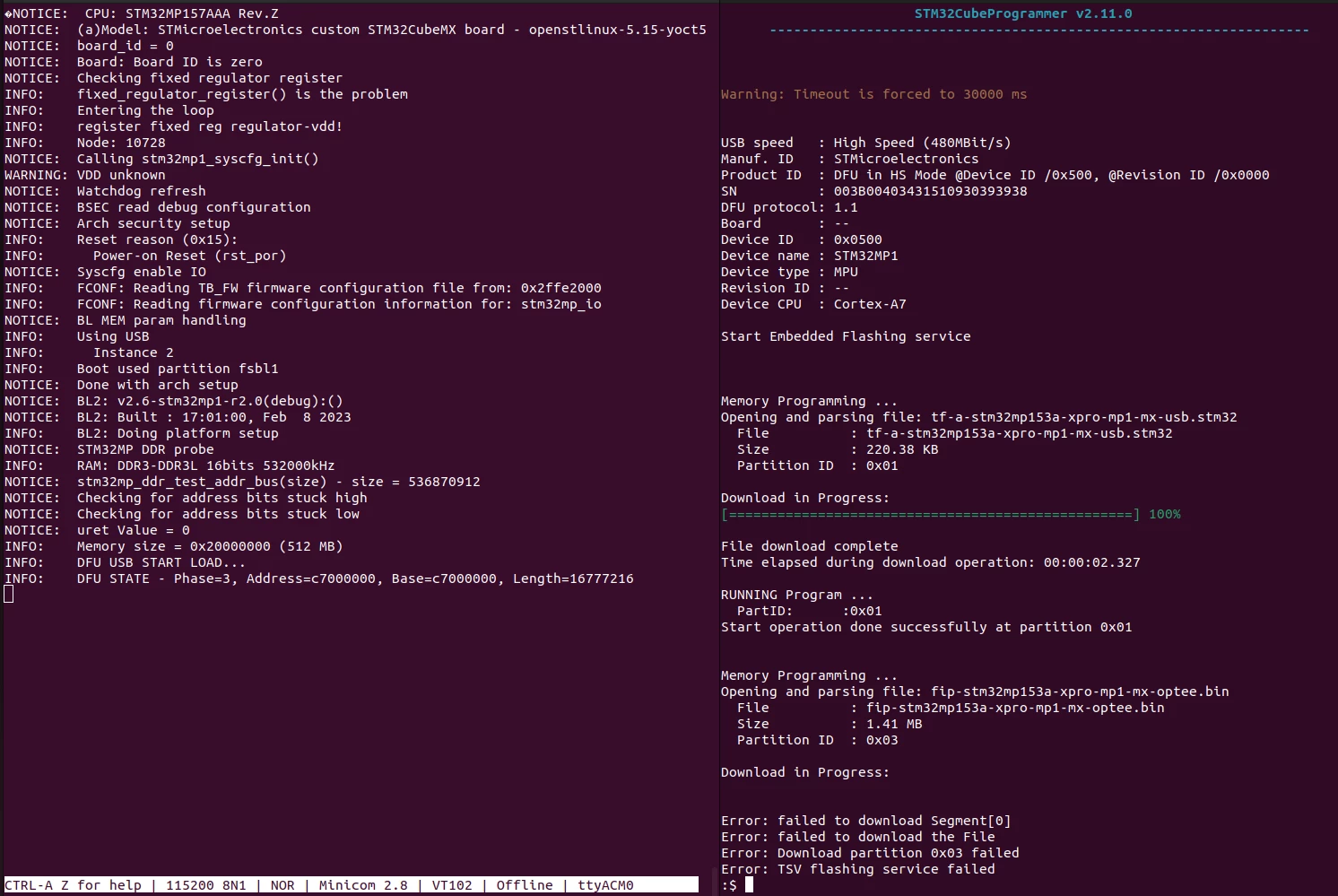

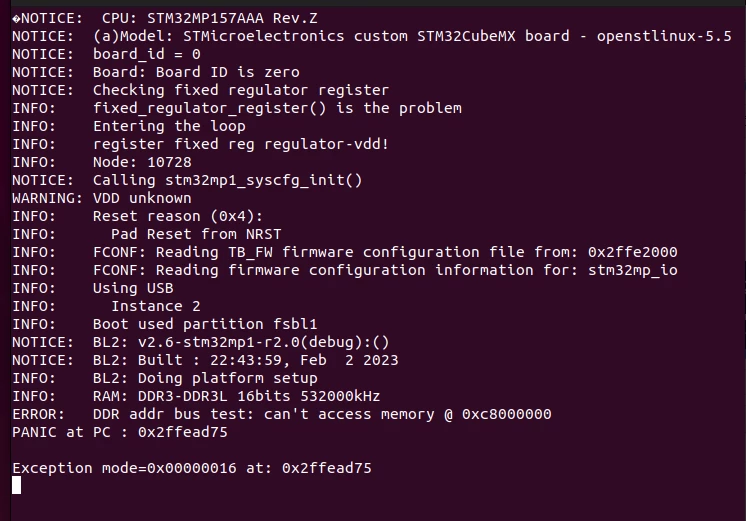

DDRUTIL passes address bus testing where TF-A fails using identical DDR configurations
I've been validating my DDR interface with DDRUTIL through the CubeMX DDR Interactive which seems to pass the tests. When I boot TF-A it is failing both address bus testing for 1's and 0's. But I can run this same test through DDRUTIL and it passes. What am I overlooking here? As for DDR configuration in either case, the files are identical.

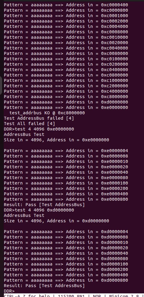

Some additional information I discovered...
Using DDRUTIL I can get the same failure TF-A is giving me if I run all the tests (i.e. test 0). When I run all the tests test 4 will fail at the same address 0xc8000000. What's more interesting is if I run test 4 and start increasing the size of test 4 across 0xc0000000 - 0xc8000000 and 0xd0000000 - 0xd8000000 and so forth I can get passes. Here's a snippet

So is this test revealing a real hardware error on my address bus or is this an incorrect configuration thing? Maybe bus speed can be slowed to resolve? Being that I get conflicting results based on whether I run the command alone or inline with other tests is confusing.

Hi @Community member​ ,
Maybe look at DDR size have you populated on your board Vs the one in various config files.
Failing at 0xC8000000 could mean only 1Gbit (128MB) is available.

What's interesting is I can now get through that initial TF-A (FSBL) boot where it want's to load FIP and it's getting stuck for like 30+ seconds then says it's downloading FIP but never does and just fails. So I'm wondering now if that's a related DDR issue.

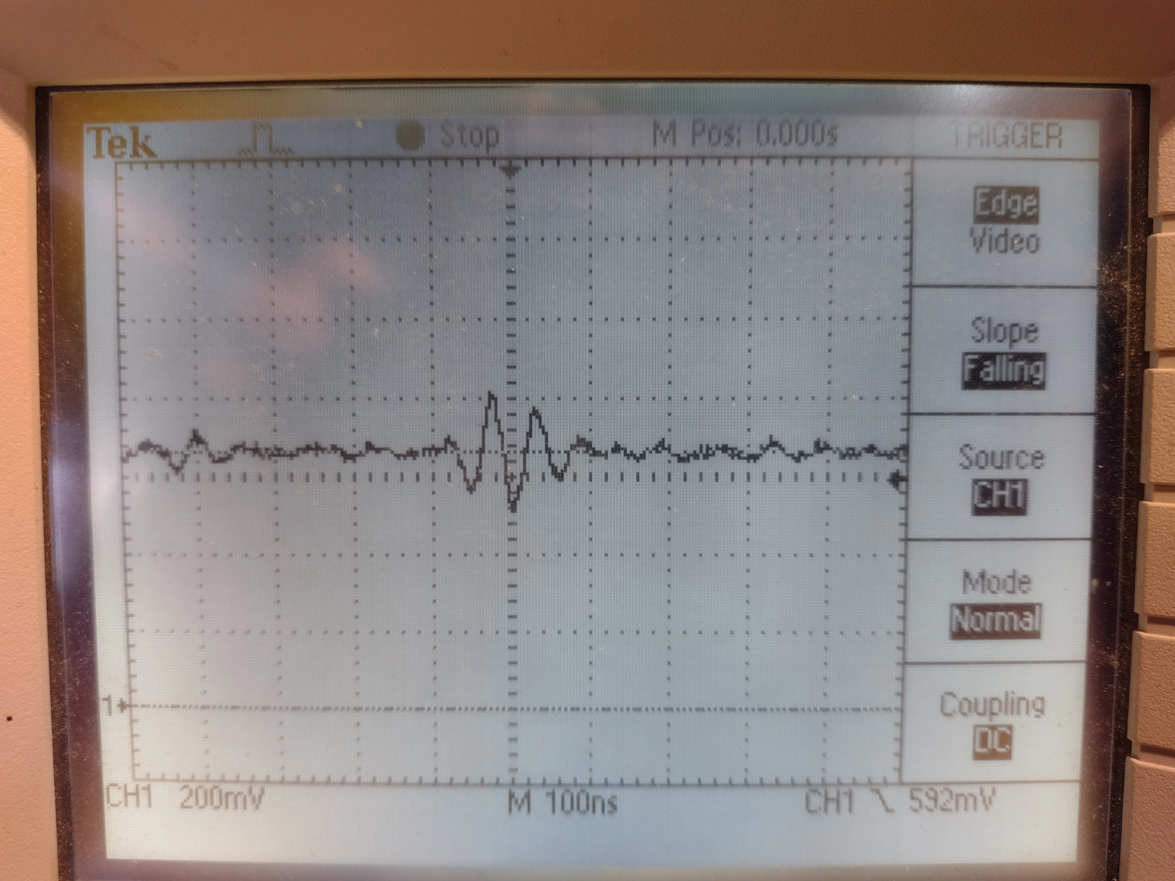

quickly looking at schematics point one potential problem
  • Using VTT for DDR VREF is not recommended as VREF must be as clean as possible and VTT is noisy. As recommended in AN5031 and AN5122, you should either use one resistor divider from VDDQ on MP15 and memory side or use STPMIC1 dedicated output.

Feb 9, 2023 16:50 UTC
Gotcha, yep I remember both of those app notes very well. I apparently overlooked that. Here's a snap shot of my VTT line even during running all DDRUTIL tests. That's the worst of it but maybe enough to cause an issue. It is around 200mVp-p. Reviewing the PCB those two signals VREFDQ and VREFCA are accessible and I could fix that.
