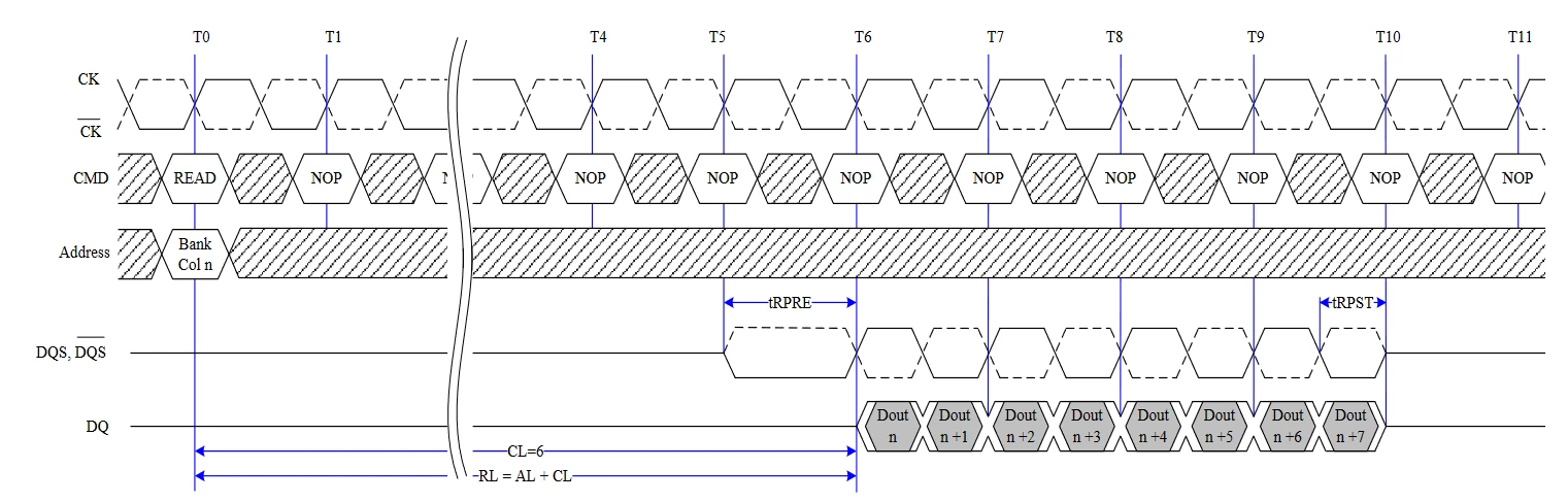

0693W00000NrnJ5QAJ.pngThis is DDR3 timing diagram. It looks very simple intgeration with FPGA to take data in or out. All I have to do is to set nearly minimal timing, so I don't waste tame on RAS CAS latency, and just latch data in the correct spot.
Like with STM32H7, I could access DDR memory simple by reading inside microcontroller memory ? and it will automatically generate all the timing s for me, is this still valid for DDR ? I don't need a lof or registers, at most 32, so I could use CAS ( or RAS ) as my address bit inside FPGA ( don't know RAS or CAS is lower in memory map )
I would also need to disable refresh command on DDR controller. Is it possible to do ?
My goal is just FPGA double math coprocessor and high level logic, since it is a bit harder to do in FPGA, and takes secons to do in microcontroler in C

So please correct me if I am wrong, you want to use the DDR interface as an FMC 32-bit data in order to offload processing from FPGA to the STM32MP1 (to use the STM32MP1 as a coprocessor in bare metal). Again, I would like to help but the DDR i/f has not been designed for this purpose, and at this time we don't support bare metal application on STM32MP15.
Also when you say "Like with STM32H7, I could access DDR memory simple by reading inside microcontroller memory ?"
there isn't any DDR memory inside the STM32MP1, only embedded SRAM. The only potential DDR memory available is through the DDR interface precisely.
Regarding the DDR controller to disable the refresh command, it will require to hack the TF-A source code which I would not recommend to do. The refresh commands are listed in the STM32MP15 reference manual and modes are linked to low power states.
