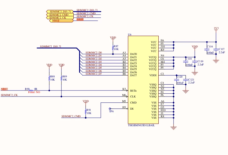

custom board of STM32mp157f-dk2 , EMMC not detected
Hi , i am using the stm32mp157DAC processor , where in custom board i added the emmc with SDMMC2,
in my hardware there is 3 bootpin, boot0 boot1 boot2 .
i did changes in u-boot DTS
i did changes in Linux DTS  only

this is the schamatic where emmc is connected
Note:   After this changes i did not change anything ,
i boot from the SD card , in U-boot i run this command
stm32 > emmc list
MMC: STM32 SD/MMC: 0
i do not want to boot from emmc just i want to check where my emmc is working properly or not or i want to see ion linux as well as u-boot that emmc is detected that's it only.
So please help me where i need to modify the codes as well as where i need to look for please help me out this .

you are trying to flash the SD-Card binaries into eMMC. You must use the eMMC ones with right TSV.
Please have a look to https://wiki.st.com/stm32mpu/wiki/STM32CubeProgrammer_flashlayout#e-E2-80-A2MMC

HI @asadullah4571
as you only put partial schematics, could you confirm the pinmux is aligned with your board ?
Did you have any console messages ?
Did you see any activity on eMMC pins (CLK, CMD in particular) ?
Regards.

Hi @PatrickF
I detected the MMC1 in Linux . i unable to detect emmc in u-boot as well as i unable to boot from emmc.I attached the linux, u-boot and tf-a-stm32mp1 dts file whatever i changes in dts files.
please check the log , where i am missing
