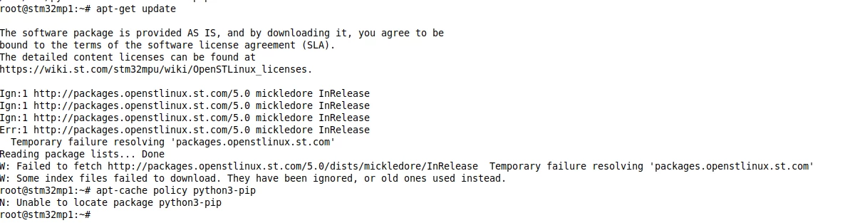

Control STM32MP157D-DK1 GPIO with python
I want to control STM32mp157d-dk1 GPIO from python i tried to use libgpiod but apt-get install python3-pip not work for me
PatrickF
PatrickFBest answer
Feb 13, 2024 2:15 PM UTC
Hi @Softcity
please try
 apt-get install python3-gpiod
as a general rule, to know if a package is available with apt-get, you could use
apt-get update
apt-cache search xxxx
Regards.

Jean-Marc B
Feb 8, 2024 12:44 PM UTC
Hi @Softcity
python3-pip is a package provided by our ecosystem.
Could you refresh the apt database and get the python3-pip status with the following commands
root@stm32mp1:~# apt-get update
root@stm32mp1:~# apt-cache policy python3-pip
 and gives me the output please?

SoftcityAuthor
Feb 8, 2024 1:35 PM UTC
Thank you for your reply, the same error unable to locate package python3-pipScreenshot from 2024-02-08 14-28-39.png
PatrickF
Feb 8, 2024 1:52 PM UTC
Sound like your board is not connected to the Internet (RJ45 or WLAN)

PatrickF
Feb 8, 2024 12:48 PM UTC
Hi @Softcity ,
Ensure you are connected to internet and the date is set to current time.
