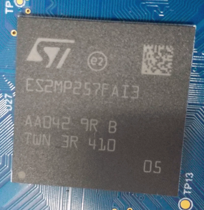

AiypsAuthor
Aug 7, 2024 5:08 AM UTC
Hi @PatrickF
Thank you for your reply.
Please find the details of the board below:
  • Main Board: MB1936-MP257F_X-C01
  • Chip details: "ES2MP257F AI3 - AA042 9R B - TWN 3R 410 - 05". "E2" is mentioned on the top.
    I have attached the photo of the package for your reference.
Note that the STM32MP257F-EV1 board has a sticker with "ES" on it.
Thank you, I understand that CubeProgrammer cannot be used via ST-LINK to debug and can only be used to flash images. We will try to use STM32CubeIDE instead via ST-LINK(SWD).
Since you are able to perform debug by connecting Lauterbach Trace32 PowerDebug via the MIPI10 connector (CN22) of the STM32MP257F-EV1, could you please let me know if there is any procedure to be followed (jumper, boot mode etc.) when
Lauterbach debugger is used.
We thought that when the board is booted using 'Development boot', JTAG (DAP) would be enabled. But unfortunately access is denied.
I would appreciate any help with regard to this.
Thank you again.
PatrickF
PatrickFBest answer
Aug 7, 2024 6:42 AM UTC
in 'development boot' (BOOT=0b0011 or 0b1100), the debug is enabled and nothing specific is needed to access thru JTAG/SWD. In development boot, the red led (LD1, close to reset button) is light.
As you are building debuggers for ST chipset, There is maybe some partnership already in place. Could you give me more details on your company and if you get the board through distributor or directly from ST (by private message if you prefer).
If it helps, here is part of the T32 initialisation I use:
