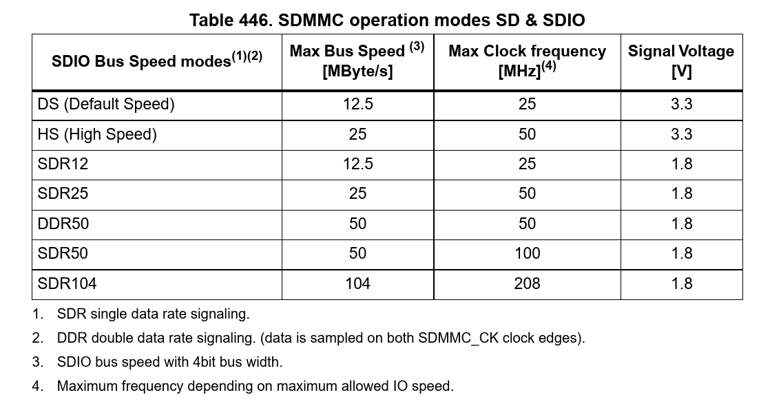

well i am not the professional to teach you about stm32mp157f and sd-card --- but afaik :
sd-card always start communication in standard mode (at 3v3 vdd), then - if card allows this - is speed switched to uhs mode (at 1v8 then) and needs to switch supply to card to do this (special hi-speed driver / vdd power switch needed for this). look in ds of cpu/mpu , look at circuit stm32mp157f-evl , how this should work.

HI @Sean_62 ,
System configuration provided with STM32MP157F-EV1 Starter Package together with Linux driver will make this for you if during SD-Card negotiation it detect a suitable mode requiring 1.8V I/Os (e.g. UHS-I in DDR50 mode)
Maybe look at https://wiki.st.com/stm32mpu/wiki/SDMMC_device_tree_configuration
For STM32MP157F-EV1, the uSD_LDO_SEL signal is controlled by GPIOF14 (defined in Linux as external regulator controlled by GPIO).
https://github.com/STMicroelectronics/u-boot/blob/v2022.10-stm32mp/arch/arm/dts/stm32mp157f-ed1.dts#L98
this regulator is tied to SDMMC1 IO voltage (and then managed by driver when needed)
https://github.com/STMicroelectronics/u-boot/blob/v2022.10-stm32mp/arch/arm/dts/stm32mp157f-ed1.dts#L382
Note that switching SD-Card IOs to 1.8V (SD-Card supply is always 3.3V) requires a very specific sequence to avoid voltage conflicts. This is defined in SD-Card standard.
