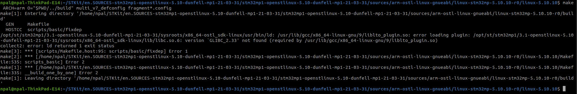

KnarfB
Aug 6, 2021 07:10 UTC
Looks to me like a path issue: The libc path is within the SDK (sysroots/x86_64-ostl_sdk-linux) but the "required by" lib lto_plugin is on a native (host) path /usr/lib/. Probably setting/correcting LD_LIBRARY_PATH or launching the command in a dedicated yocto devshell helps.

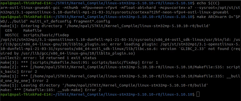

Hi @KnarfB​ ,
Previously i mentioned it manually changed the value of the LD_LIBRARY_PATH variable to /lib/x86_64-linux-gnu/.
Looks like that does not work at all. I might have got it working in a wrong way since i did not export the SDK first.
SO now every time I export the SDK and try to do a build i get above error. I also understand the problem but cannot seem to find any solution. 0693W00000D2A2XQAV.png@Jean-Marc B​ @Community member​ , kindly provide your inputs as well if possible. Anything will be appreciated.

It fails at step : make ARCH=arm O="$PWD/../build" multi_v7_defconfig fragment*.config
Kindly help me out.

@NPal.2​
Thanks your for your feedback.
It seems to me your gcc installation is based on gcc-10.x (from your screen snapshot, I read /usr/lib/gcc/x86_64-linux/10).
On the two supported platforms for OpenSTLinux, for Ubuntu18, the default gcc is 7.x and for Ubuntu20, the default gcc is 9.x.
Does the installed and used gcc version on your machine be the cause of your problem because too high compared with 7.x or 9.x?
Best regards,
--JM
NPal.2
NPal.2Author
Aug 12, 2021 08:46 UTC
Hi @Jean-Marc B​ : Thanks for pointing that out. I removed all other version of GCC to make sure it does not conflicts with the one i need and installed 9.x version. However i am still getting this build error.

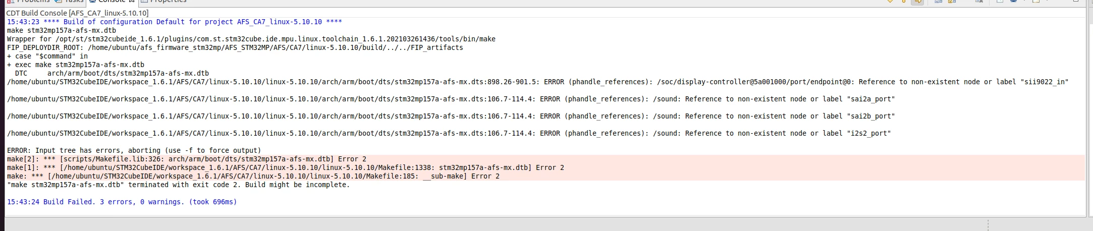

Hello! I use developer package+STM32CubeIDE. At a certain point (I don't understand why) I stopped compiling the linux kernel device tree. Everything else compiles without errors (tf-a, u-boot, modules). What could be the reason?
NPal.2
NPal.2Author
Aug 20, 2021 08:08 UTC
Hi @AlexandrShipovsky​ : If you look closely at the error message it says reference to an non-existent node. Are you sure you dts file has correct changes in place?
AlexandrShipovsky
Aug 20, 2021 08:12 UTC
In fact, I did not change this file at all. The file code was supplied in the developer's package. These devices are all present on the STM32MP157A-DK1 board
