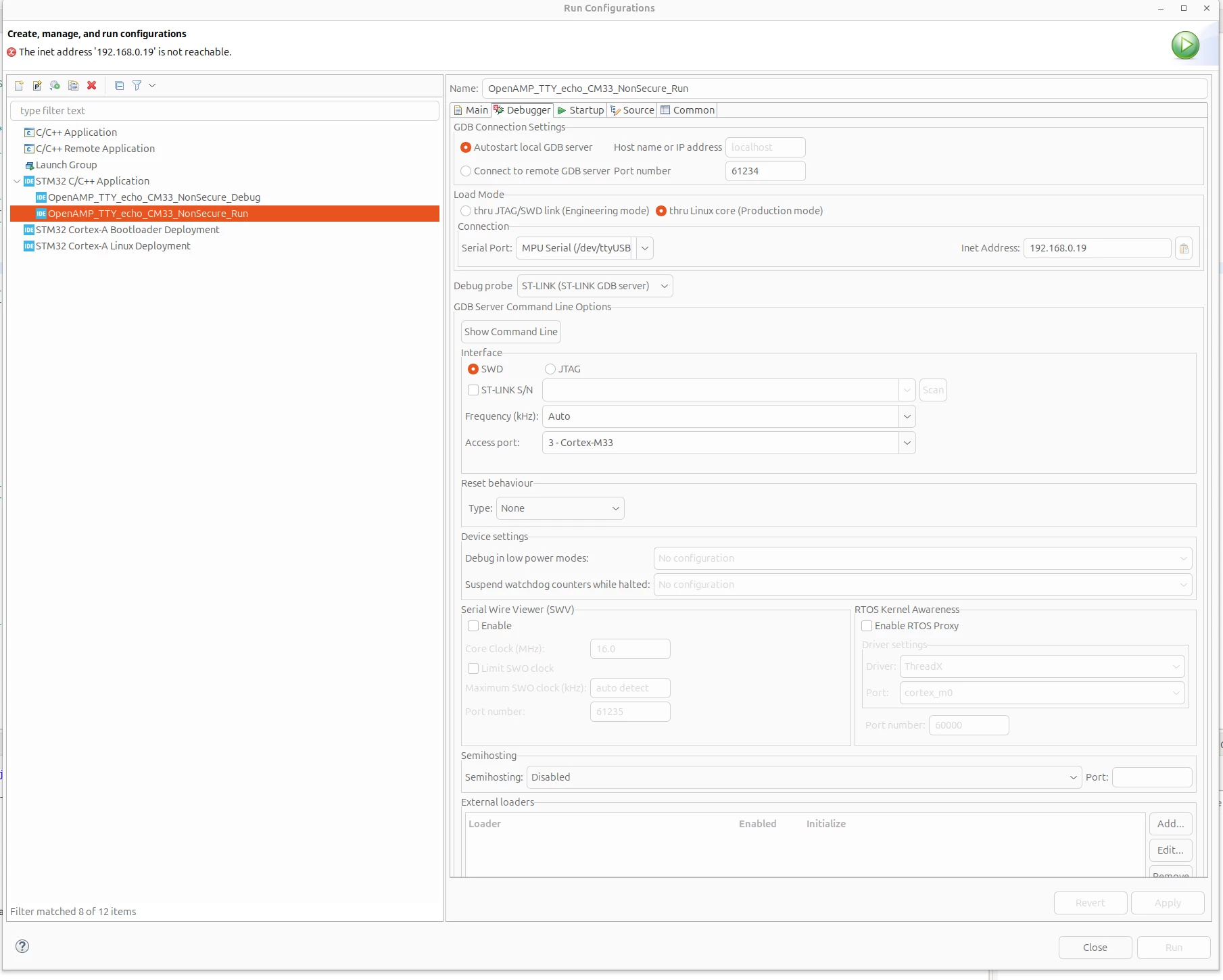

Cant pregram/debug M33 core on STM32MP215DK-1
Following the tutorial here, at step 8, I get to the part where you load firmware onto the dev kit, but I always get an error "No ST-Link detected".  As far as I am aware, programming should be done over the USB cable, or UART, not ST-Link?
The board is running Linux OK, UART terminal is working, so is IP over USB cable.  The run configuration I have is show below.  What am I doing wrong?
I checked with STM32CubeProgrammer and there are no programming interfaces available over USB or UART, and no ST-Link..

OK, I worked it out.  It seems you do actually need to connect an external ST-Link.  I must have missed that part of the tutorial, if it was in there...
