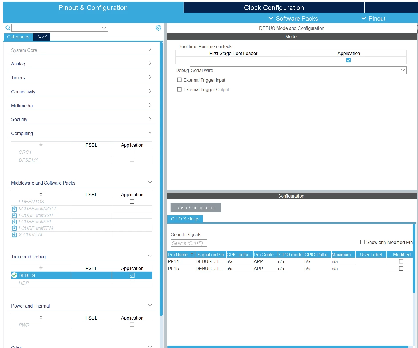

Hi ​@vad_74 ,
I do not have your kind of setup but I tried to reproduce the same issue on STM32MP135F-DK.
My code flashed correctly.

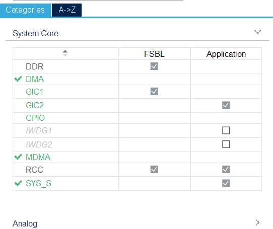

What I did:
 - In Cubemx, Selected these configuration
then generated the code.

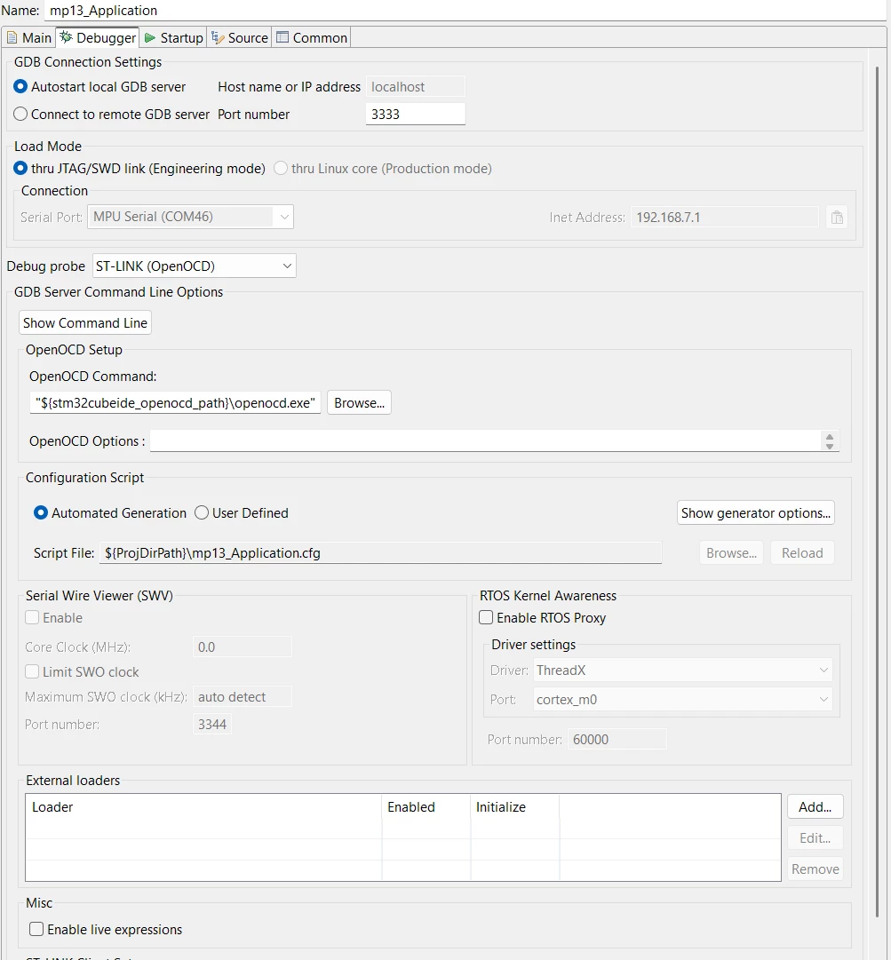

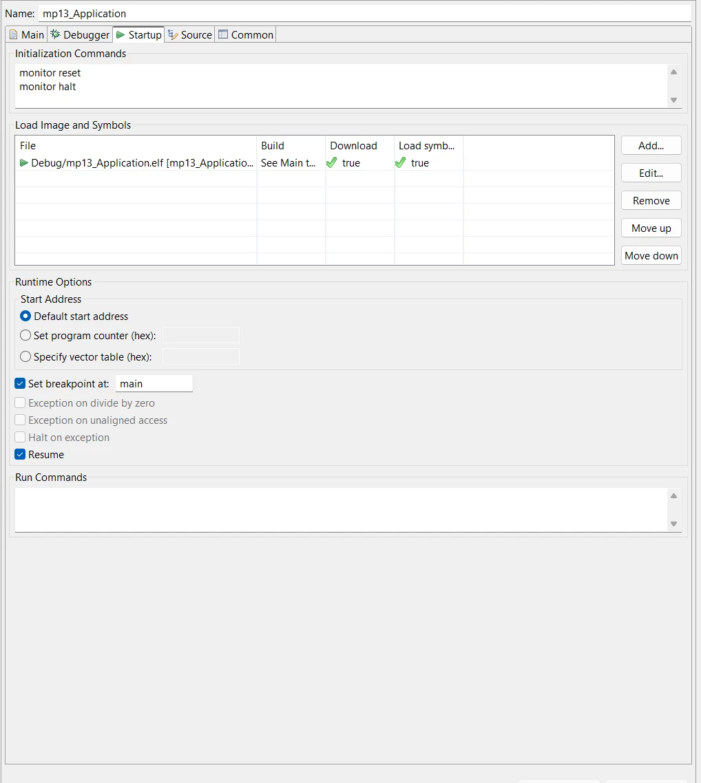

For Debug configuration in my cubeide:
After doing this, I ran my code, it worked. There was not error.
